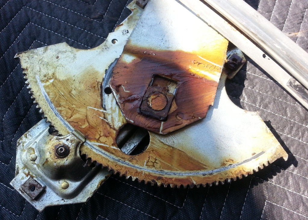

I went ahead and used the white lithium on the door latch/lock and rods. Once the heavy rifle grease shows up this week, I'll use that for the window mechanisms. I ended up "fine tuning" the fittment of both doors. In hind sight, they never really shut that tight before the paint/body work. I bent the sheet metal retaining plate behind the jamb enough to remove the heavy striker plate anchor. This allowed me to elongate the striker bolt hole from the door side of the jamb no more than 1/4". Once reassembled, the striker bolt washer still covers the hole and allows the door to actually close flush with the quarter panels and compress the door weatherstrip. What a difference! With rebuilt door hinges and Dynamat-lined doors, they now close effortlessly and sound SOLID! Here are photos of before/after the grease bath. I slathered it on and "packed" it as if they were wheel bearings. Here's to another 40+ years!

Check out this heavy factory grease. Man, this stuff is the bomb! It seems to fit the description of Cosmoline...
