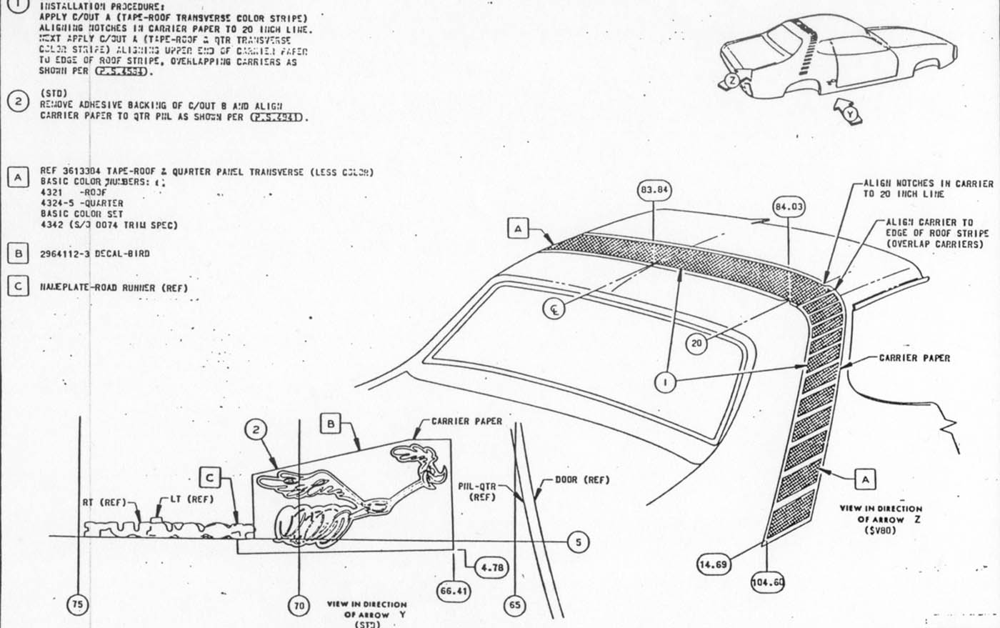

Post by Eric » Tue Jun 27, 2006 9:20 pm
original factory document for 72 strobe placement, both vinyl and non
(100.64 KiB) Downloaded 1012 times
BlackGTS
Post by BlackGTS » Tue Jun 27, 2006 9:47 pm
When you say both vinyl and non,what do you mean by non?
Post by Eric » Tue Jun 27, 2006 10:07 pm
I mean the stripe placement is correct for the canopy vinyl roofs as well as painted roofs. The stripe itself should be tape, not paint.
