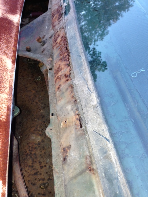

Post by jonny0666 » Fri Sep 06, 2013 8:51 am
Hey, thanks I'll check that out. Here are a couple of pictures of the problems.
upper drivers side windshield corner
Cowl/ windshield bottom

WOW! You have some major rust problems. To my knowledge no one reproduces any sheet metal for around the windshield. You are going to need to find a donor car. How bad is the rest of the car? Did you remove the windshield to see how bad it is? Is the inner cowl rusted also?

Not too hard to fab small patches around the windshield, inner cowl is tougher.
A lot of these repairs will be covered when the car's finished, a very good thing!
I'd make as many as you can.

I am facing a similar dilemma on a 71 Charger I bought. My solution was to buy a parts car, which will give me all the parts I need. You probably need a roof skin as well, so buying a parts car will likely be your best solution. Here is the cowl on my Charger.

The e-body panel will work...only difference I know of is a cosmetic contour difference near the hood hinge area...I don't remember which side. I don't know why they are different but I noticed it at Carsile a couple of years ago when I was trying to find the differences.
