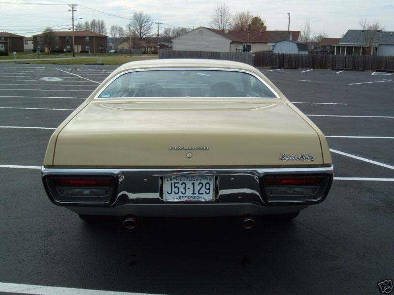

The most notable SS Plus upgrades from the Sat. Sebring included: Bucket seats, Rallye dash, and the 318 V8 was the lowest standard engine you could get. The SSP badges consisted of two separate emblems, Satellite and SebringPlus. They are not re-popped at this time. They turn up on eBay once in a while. Emblems go on each quarter panel just behind the door, and on the right side of the trunk lid.

original paint/survivor car photos for emblem placement reference
