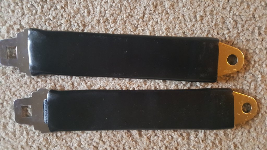

First picture has 2 sets of buckles/receptacles sewn together. My original ones had these together and on one, had a extra single buckle ALL together in a plastic sleeve . The other one had 2 buckles sewn together and a male as a single ALL together. I think these go on either side of the tranny hump, on the inboard side of my bucket seats.

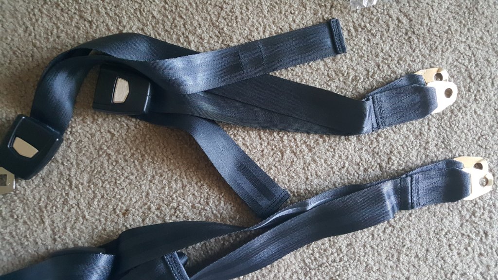

Second picture not sure where these go.

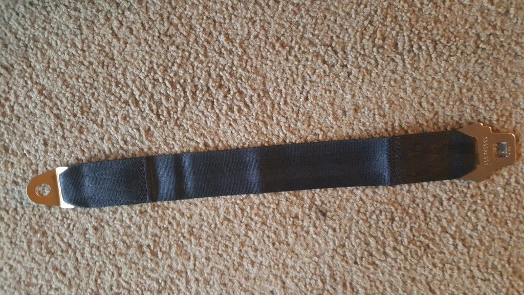

Third- Rear middle, mounting on the hump for the rear end?
