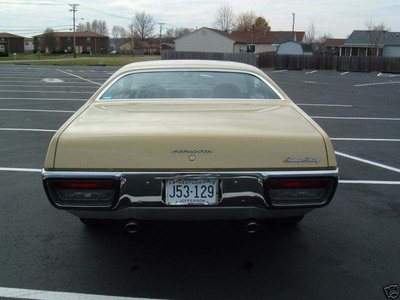

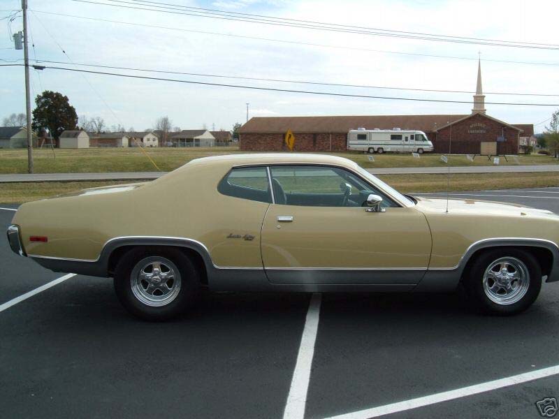

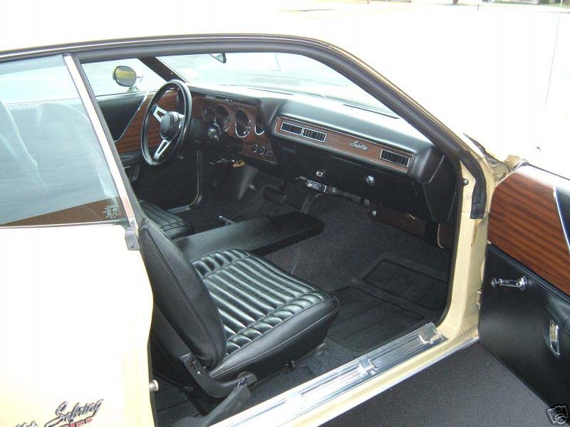

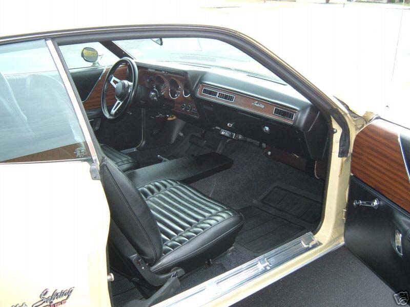

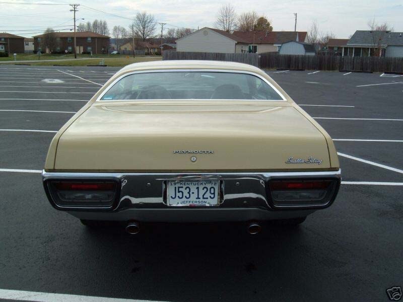

original paint/survivor car photos for emblem placement reference
