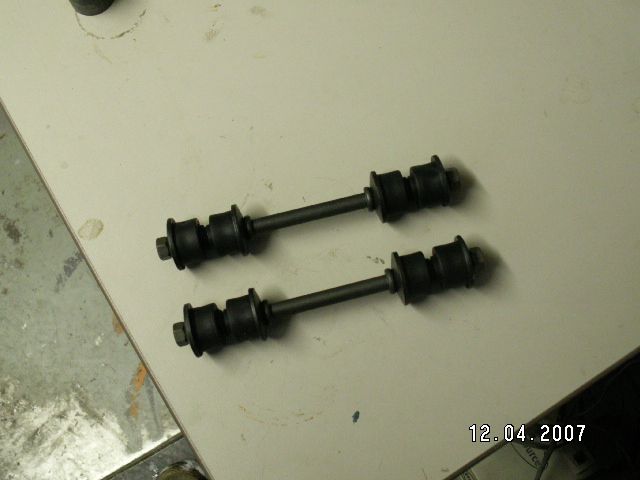

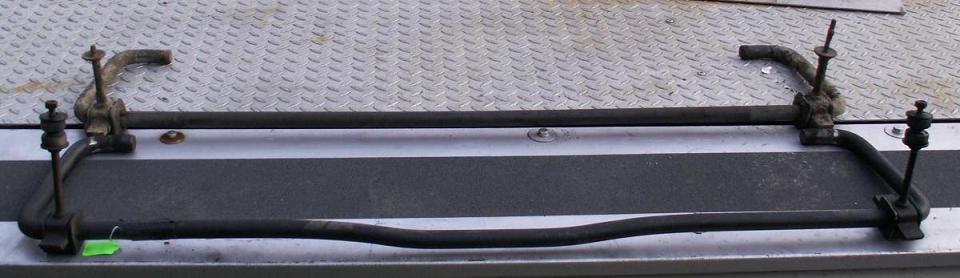

Do you have a picture of your old ones?
farmboy70
- Posts: 136
- Joined: Sun Aug 21, 2011 12:16 pm
- My Cars: 1971 Roadrunner 383 auto sir grabber Curious yellow
Re: So what do you guys do about your rear swaybars?
Are these what you are looking for?
These are the ones that i'm looking for or something that will work.

- 72RoadRunnerGTX
- Posts: 593
May not have the exact same stand-off length but will work on that rear bar in a pinch.
OK now I see what you are looking for, the only 72 Body I have worked on did not have that style bar and link arrangement.

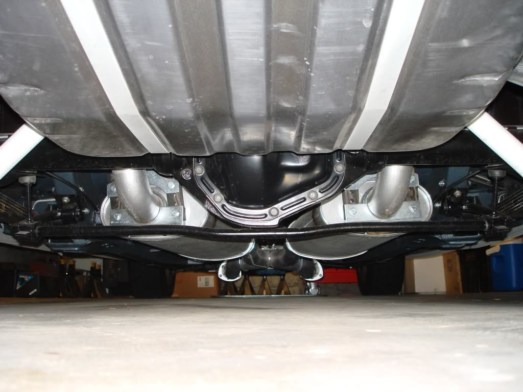

Does anyone have a photo of how the bar is bolted to the rear end. Will a bar off of a 72 RR fit on a 71 GTX
8 3/4 ? The GTX was born without one, but I hear it makes it a much better handling ride. Worth the trouble or not? Not building a show car. Just want a nice looking(and fun to drive) driver.

“Will a bar off of a 72 RR fit on a 71 GTX 8 3/4?”
Yes, all the original 72’ rear anti-sway bar components for the 8 ¾” diff. will bolt directly on the 71’, screw holes in the frame rails should already be there. Rear bars from 73’ and up b-bodies can fit as well however there are some variations in the dimensions of some of the mounting hardware.
“Worth the trouble or not?”
Definitely worth the effort and expense done correctly.
