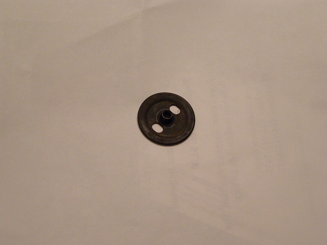

opened my door and this fell out, where does it go

One of four fasteners that secure the glass to lower regulator track. Likely a screw and a rubber washer or two floating around in there too.

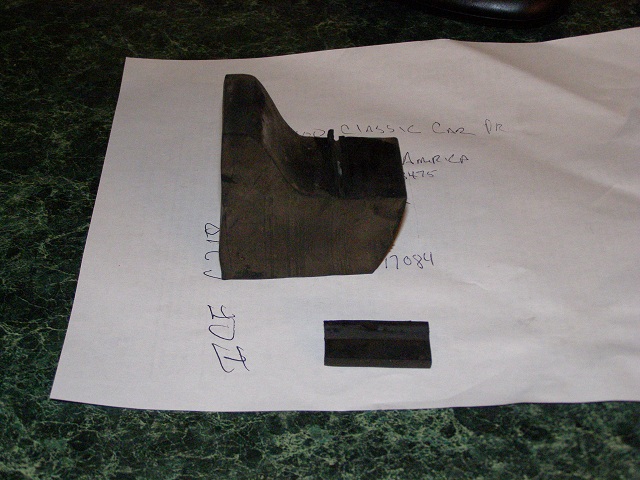

got the door panel off..and found this laying in the bottom anybody know where I can get a replacement

Since all it does is stop the window glass - and doesn't really take a lot of abuse, I don't think you need to replace it. I see the tab is busted off, but If it were me, I would just use weather strip adhesive and just stick it back in place! Too many other parts you need to spend $$ on. This one could be salvaged. :)

Post by sdweatherman » Wed Jun 15, 2011 10:46 am
I might have a good used one laying around for cheap. Let me know if you are interested. Scott.
