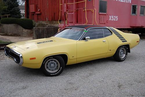

Post by 1972RM23 » Wed Dec 02, 2009 7:41 pm
This car belongs to a member of the RRNest (I think) anyway it has a canopy vinyl top on it using a full vinyl top (seams in red) and trimmed off the back half; which in incorrect.
A correct canopy vinyl top will have seam (as shown is green).

Post by Smellslike1974 » Wed Dec 02, 2009 9:40 pm
Gotcha.thanks! :beer:
