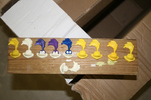

Post by mopar71 » Sat Jul 14, 2007 9:54 pm
Cool, Do you remember the color,I did one with nail polish but had brush marks.here is a pic of my test dummies.
