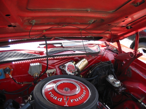

Last question for the day, I promise. (fingers crossed)
What is the correct routing for the wires that go up to the hood mounted turn signals? It seems like there is enough wire to go around the engine compartment 50 times. :lol:
I don't plan on putting the hood insulation in at this time, so I'm hoping they didn't just stuff it under there.

If memory serves....correctly-- the A0-1 cars had those plug in by the front directionals.
Mine wasn't an a01 car so I just spliced in to the front directional wire inthe harness.

I have a 71 Road Runner with the hood mounted turn signals. I beleive the routing to be original. The connector are the original and are falling apart. the wires run along the hood towards the brake booster where they connect to some round push in connectors. Anyway, I've attached a pic to show how they are routed. Hope this helps some.
Ron

That's exactly what I was looking for.
Thanks lots!!!
