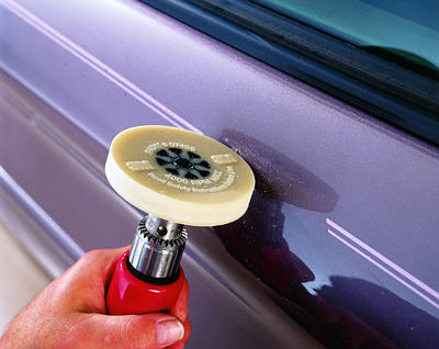

They also make a gummie rubber 'disk' that is designed to remover stripes and such without damaging paint. Sold at most auto-body supply stores.

I have used one of these. Works just like a pencil eraser. The heat gun can damage the paint if you get it to hot. Plus, if the stripe is hard and cracked, you will never be able to peal it off. It will just come off in pieces.

If the vinyl on the stripe is old and brittle, a heat gun won't work very well, but the eraser will. The erasers are primarily intended for pin strips though. Doing a large stripe will probably be very tedious.

yeah its old cracked up all over so ill get the eraser might take me awhile to get off but im gonna wait till i get new stickers thanks allot guys :D
