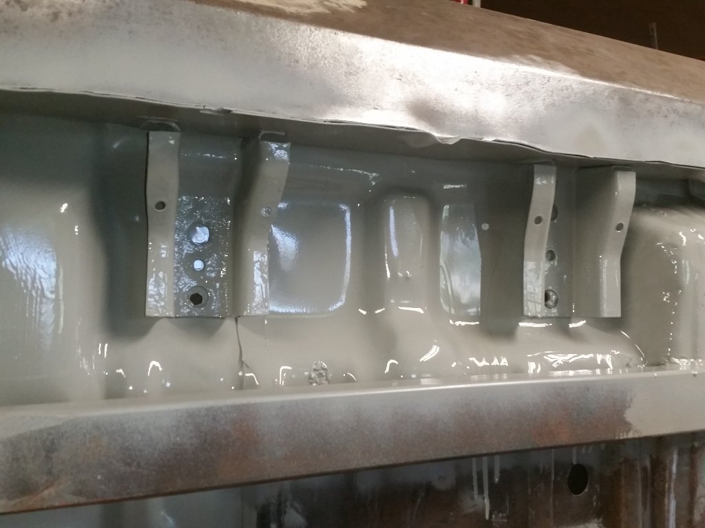

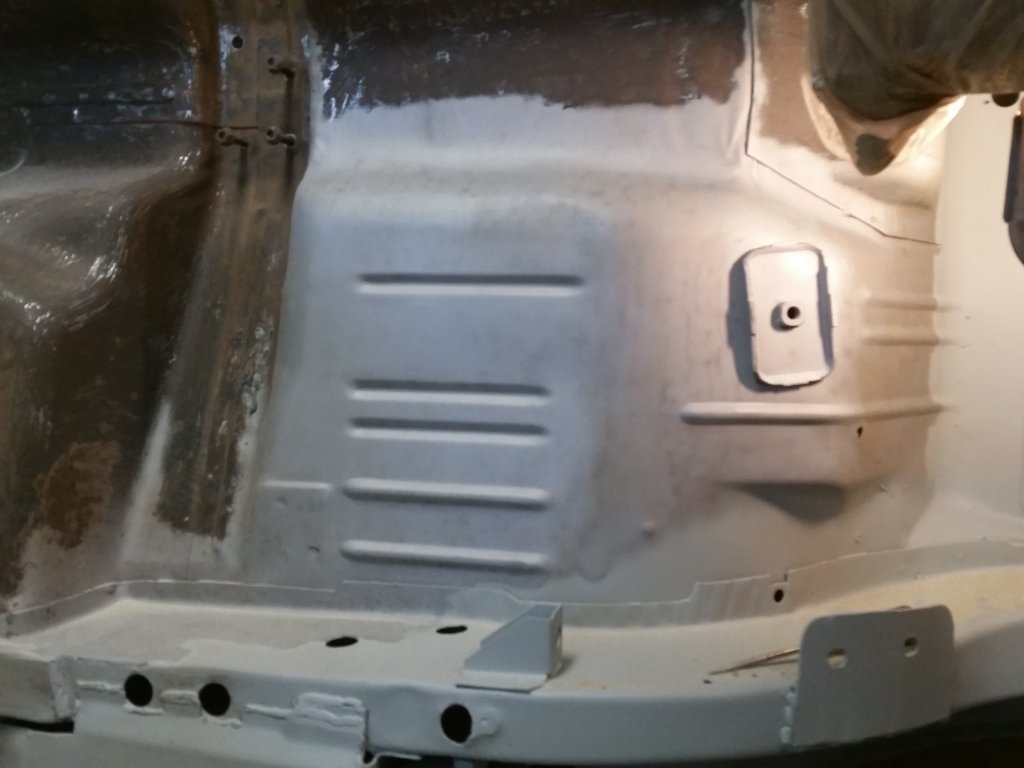

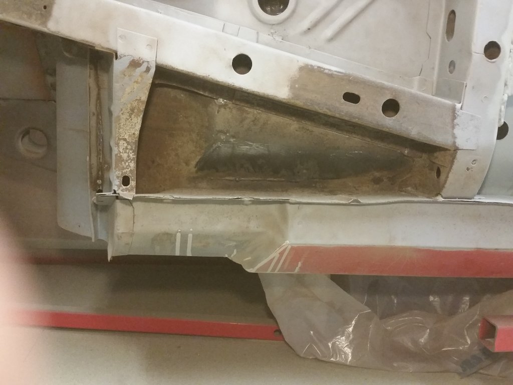

So now I'm going back to the front part of the car to where the front torque boxes sit.
I decided to buy a spot sandblaster gun.
The attachment spot blaster. JPG is no longer available
I want clean up the are where the torque box will go as it won't be accessible once the torque box goes in.
So I borrowed my good friends portable air compressor that runs on 110 power and is mobile.

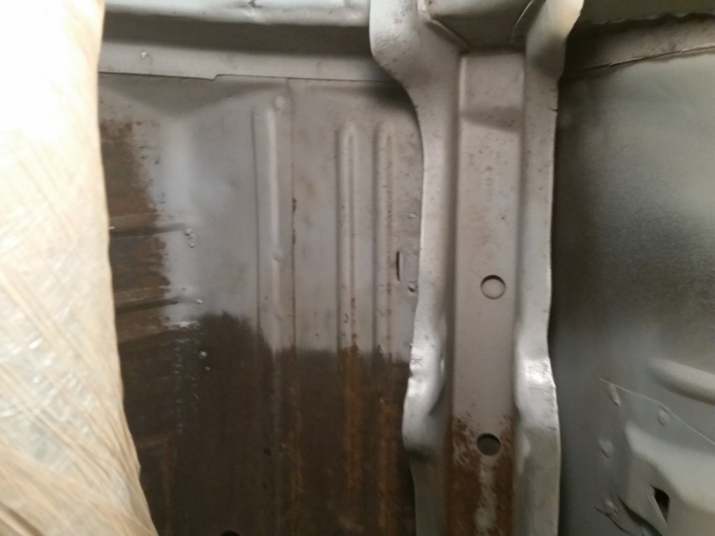

Here's the before pics.
The attachment 20171202_120423.jpg is no longer available
The attachment 20171202_120417.jpg is no longer available
And now after blasting and put some primer on it.
The attachment April 28 (4).jpg is no longer available
April 28 (2).jpg (91.79 KiB) Viewed 29049 times

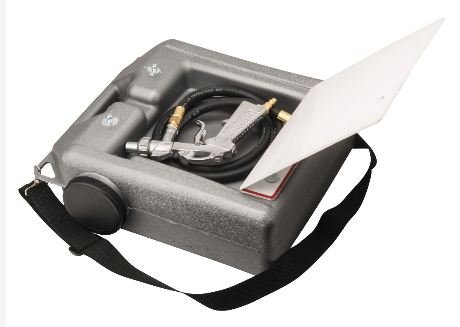

And heres the picture of the spot blaster I bought.

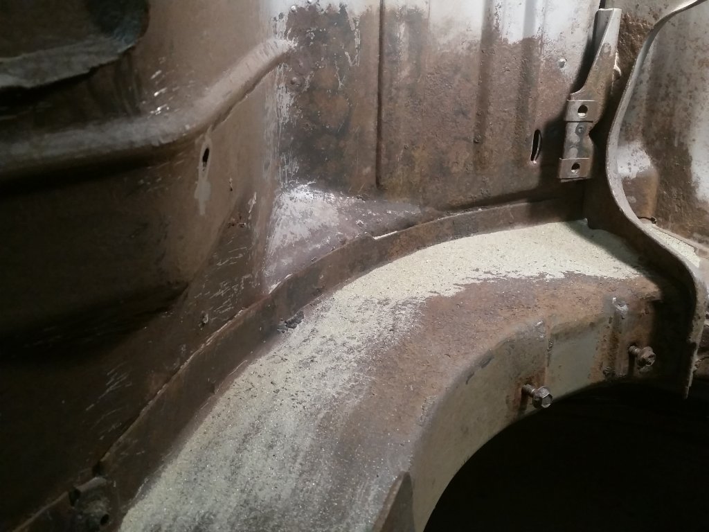

Post by 71Beeper » Tue May 15, 2018 8:38 pm
So I got a little more done.
I ended up pitching the little spot blaster. It would not get into the tighter areas very well.
With the reservoir on the top, you couldn't turn the gun at any angle or the sand would stop flowing.
So I went and bought a portable 2.5 gallon kit. This one works much better.
I got the top area done right up to the rear torque box.

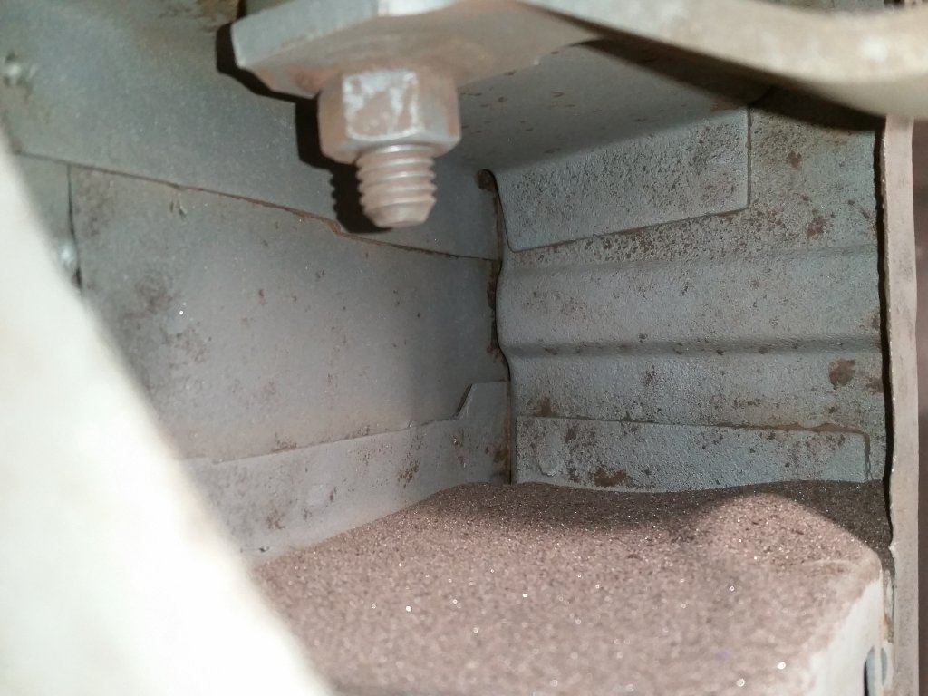

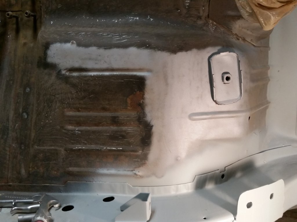

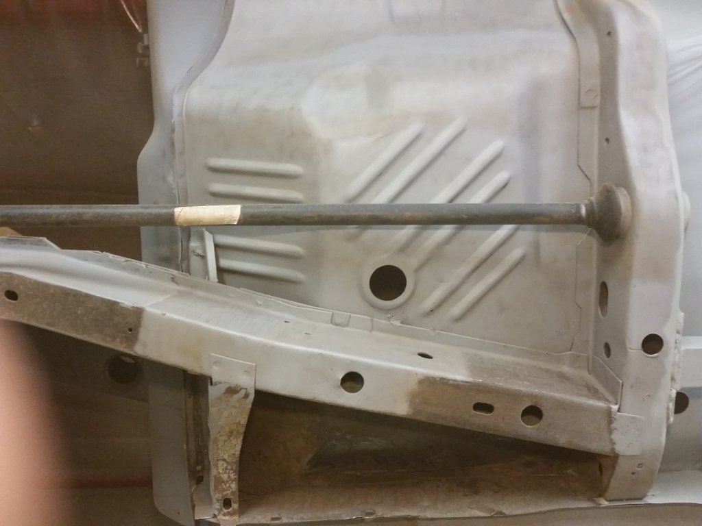

Post by 71Beeper » Sun Jun 03, 2018 7:36 pm
Continuing on with blasting. I've stopped using sand - it's too dusty.
I've switched over to recycled glass, a 30 to 60 grit grade. Much less dust. I'm blasting the rear shock mount cross-member.
May 28 (2).jpg (86.67 KiB) Viewed 28953 times

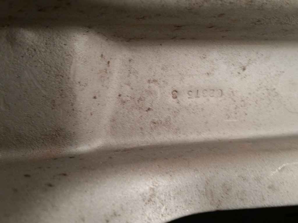

I'm seeing some part number stampings
May 28 (9).jpg (88.67 KiB) Viewed 28953 times
May 28 (13).jpg (79.9 KiB) Viewed 28953 times
Post by 71Beeper » Wed Jul 04, 2018 1:41 pm
Due to the intense heat, the compressor is pushing out air filled with water vapor. That in turn is clogging up the blasting gun.
Also the recycled glass is starting to clump up. With all those issues the blasting has been slow going. But I did manage to get more of it done.
May 28 (7).jpg (67.59 KiB) Viewed 28863 times

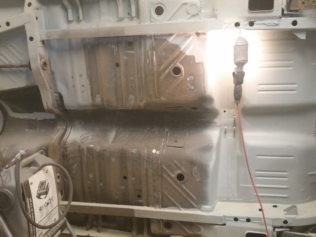

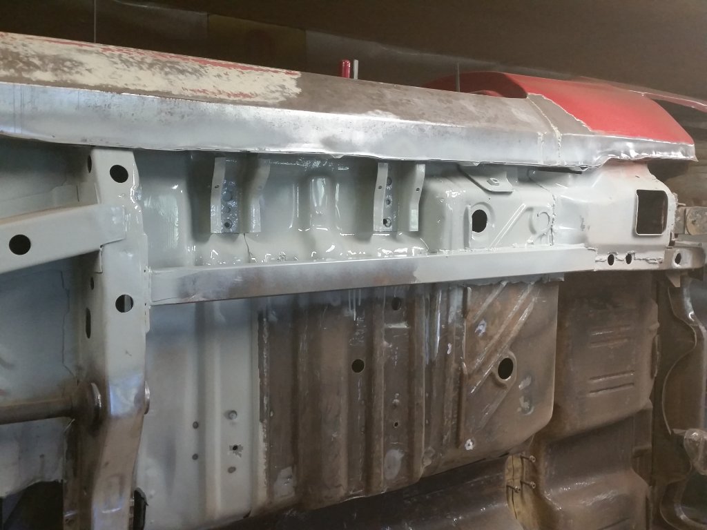

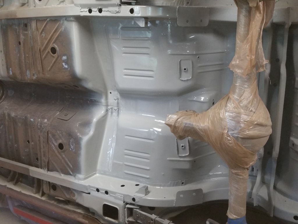

Post by 71Beeper » Sat Jul 28, 2018 9:47 pm

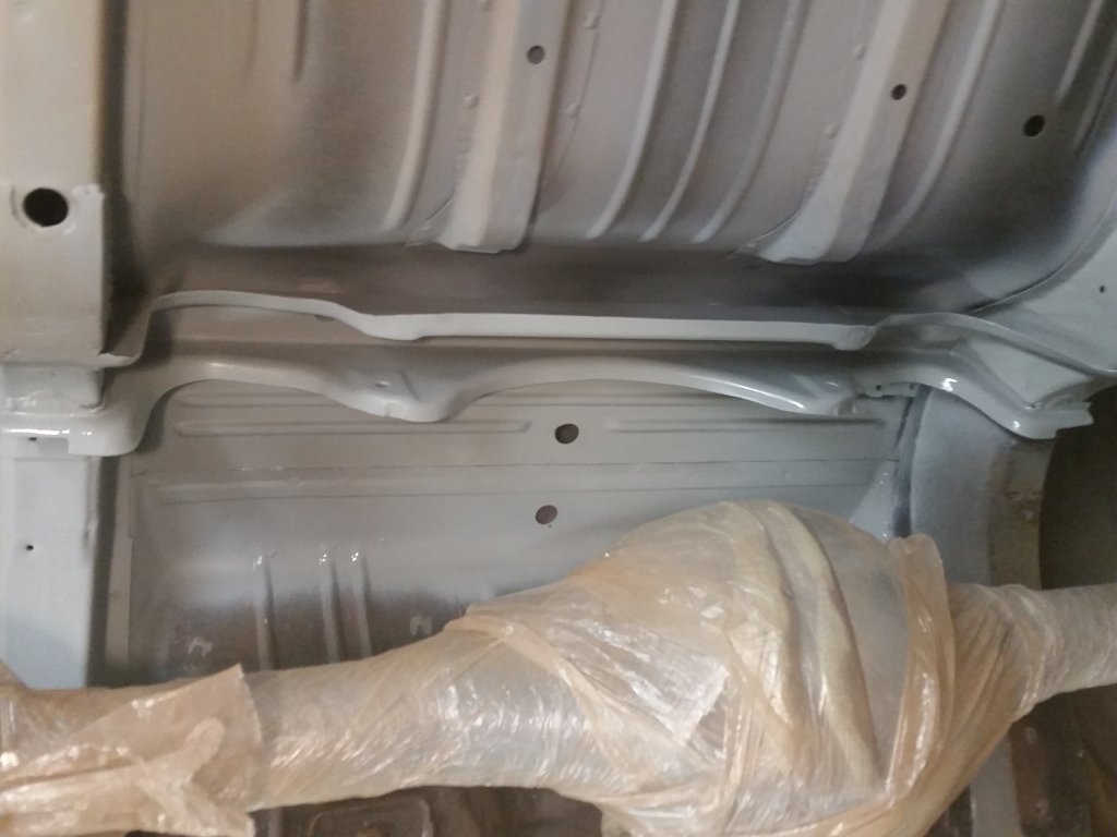

Made the most progress today.
With the weather being dryer out - I wasn't getting as much water thru the air lines as previously.
Progress went from this.
July 28 (11).jpg (88.99 KiB) Viewed 28827 times
To this.....
July 28 (13).jpg (73.3 KiB) Viewed 28827 times

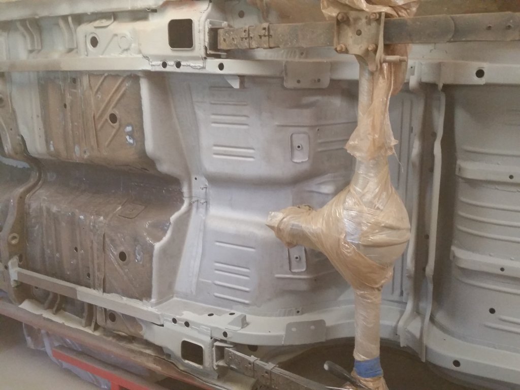

To all of this....this is all bare steel.
July 28 (24).jpg (98.66 KiB) Viewed 28827 times

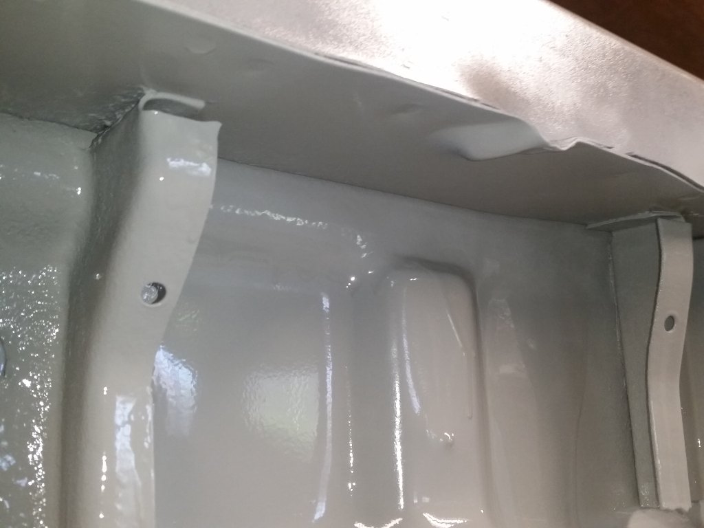

And now after a coat of primer added.
July 28 (27).jpg (97.68 KiB) Viewed 28827 times
July 28 (28).jpg (99.55 KiB) Viewed 28827 times

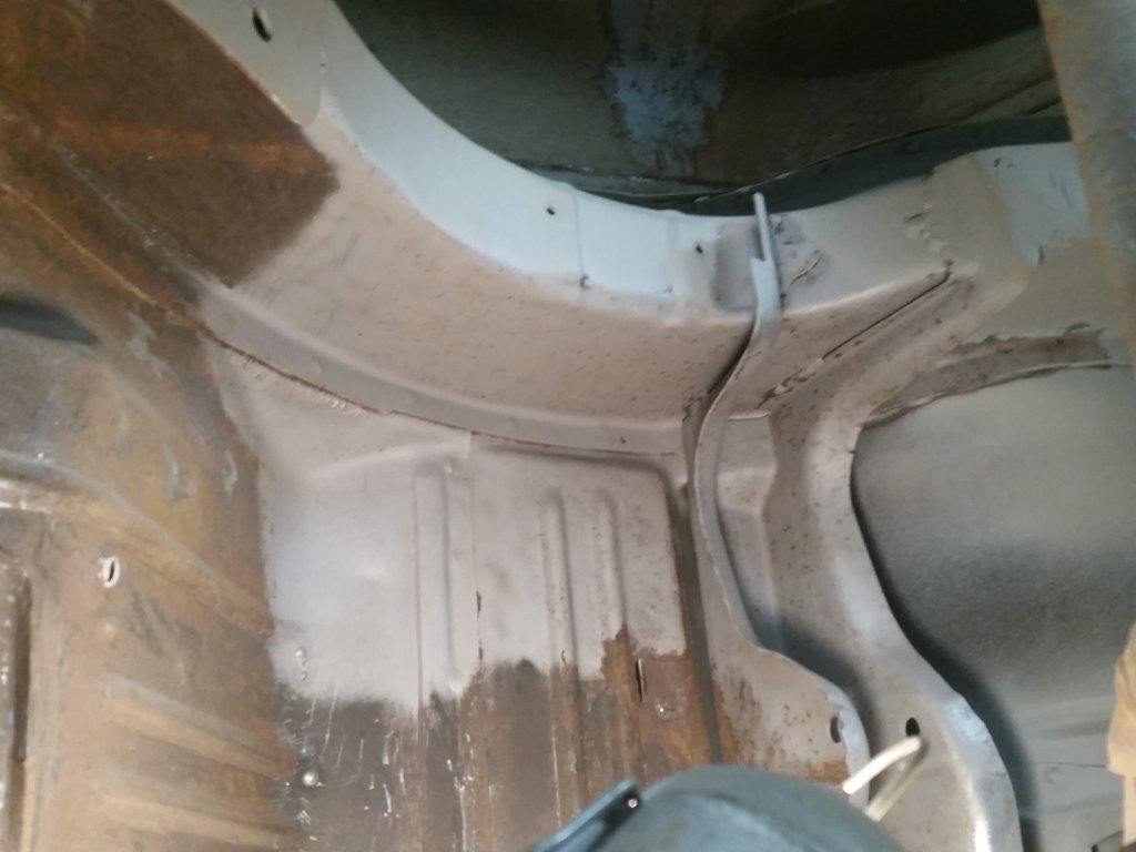

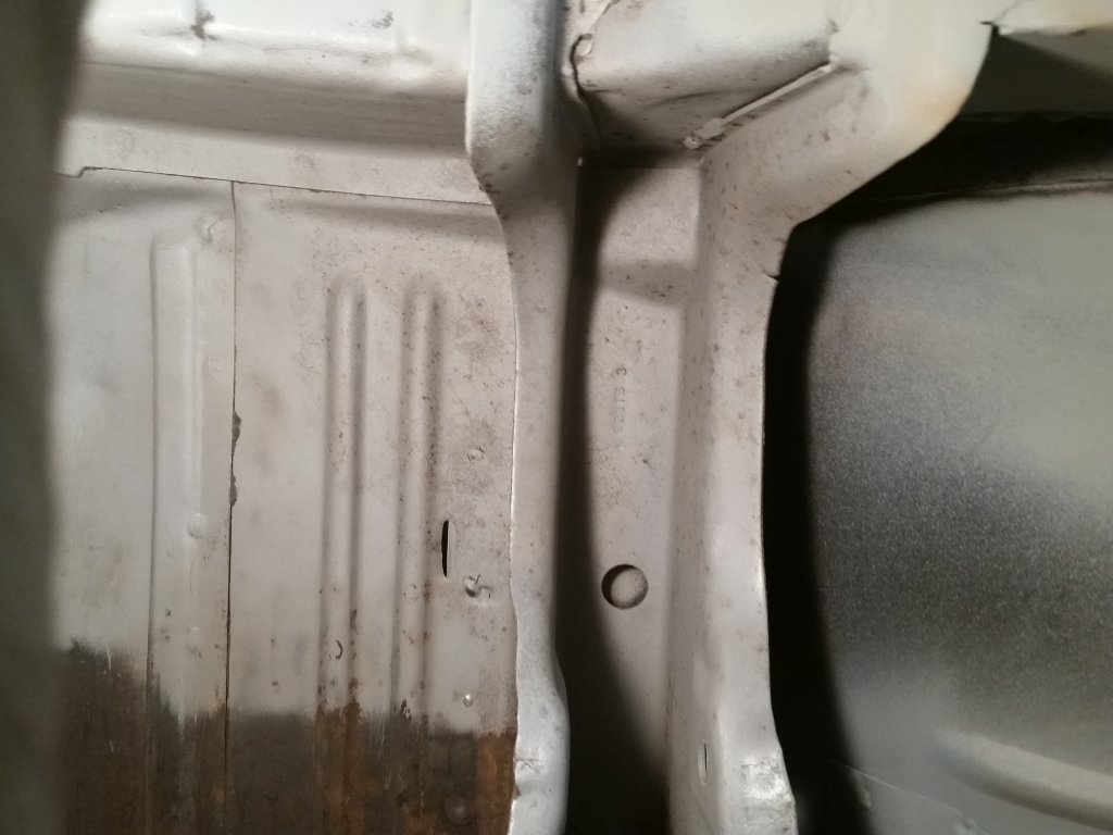

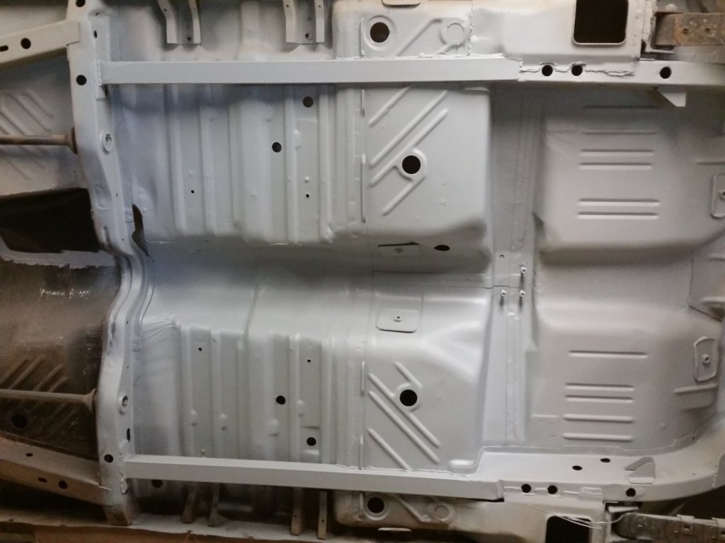

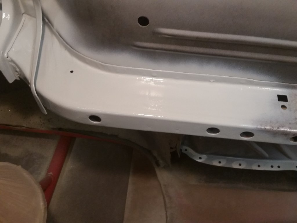

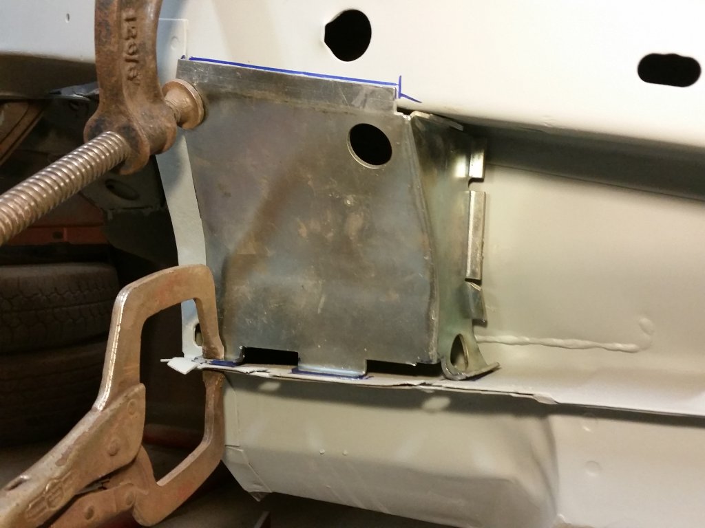

Post by 71Beeper » Wed Oct 10, 2018 7:51 pm
I was finally able to finish up blasting the rest of the underside and getting it primed.
Sept 9 (13).jpg (99.93 KiB) Viewed 28557 times

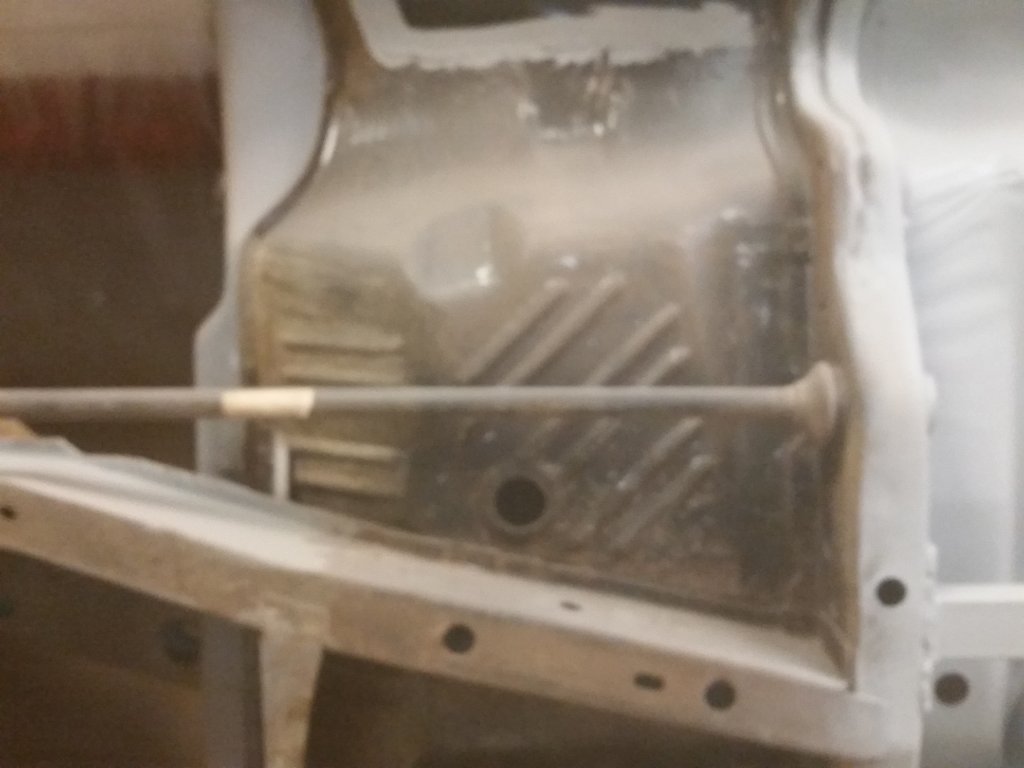

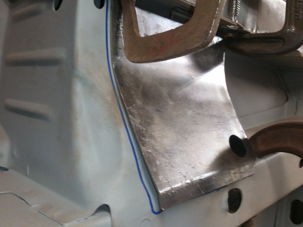

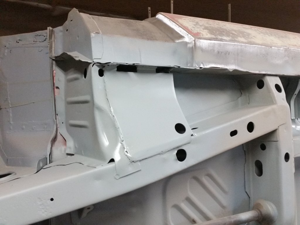

Now the fit-check for the front torque boxes.
Here's the drivers side.
Sept 9 (18).jpg (82.26 KiB) Viewed 28557 times
And the passenger side.
Sept 9 (24).jpg (64.19 KiB) Viewed 28557 times
Sept 9 (29).jpg (86.45 KiB) Viewed 28557 times

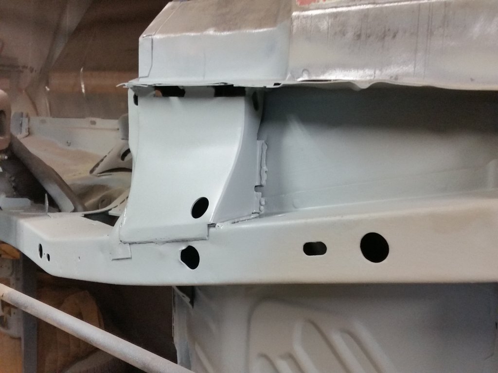

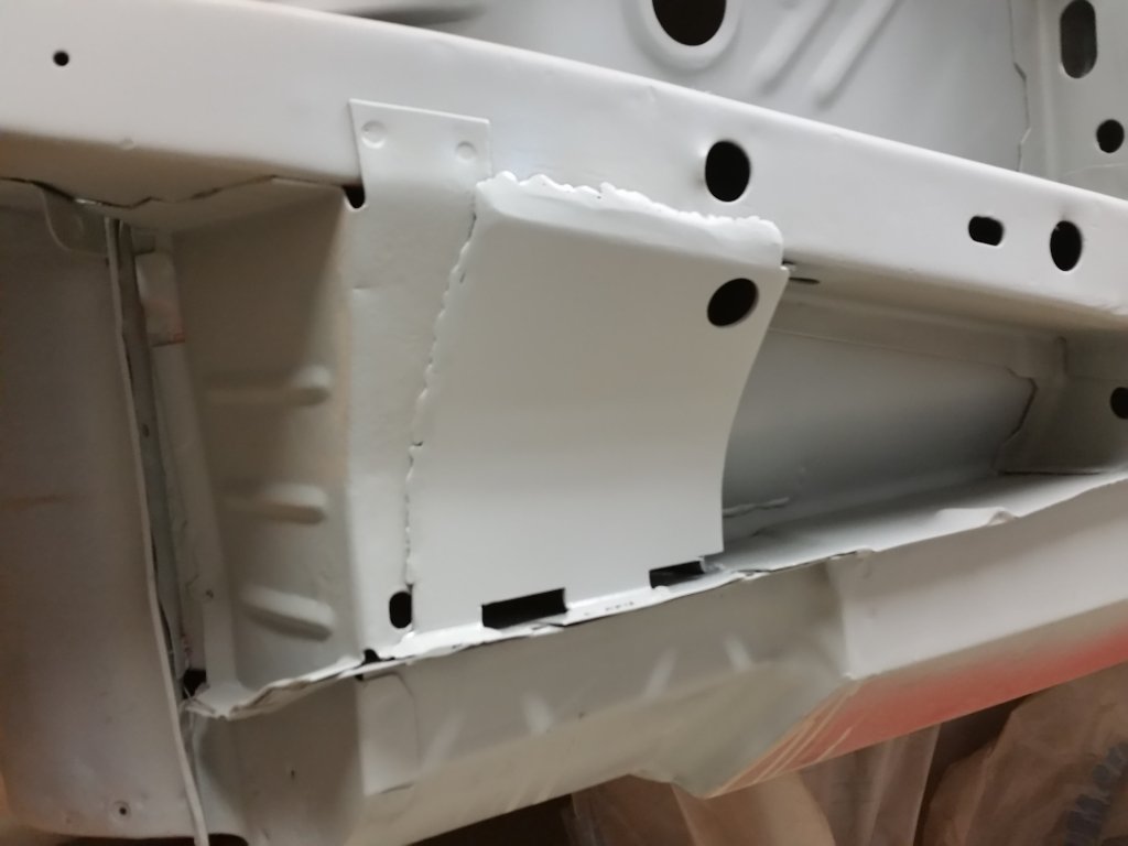

Next is to prep for welding them in......

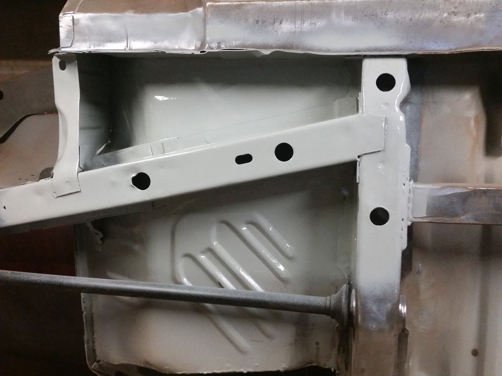

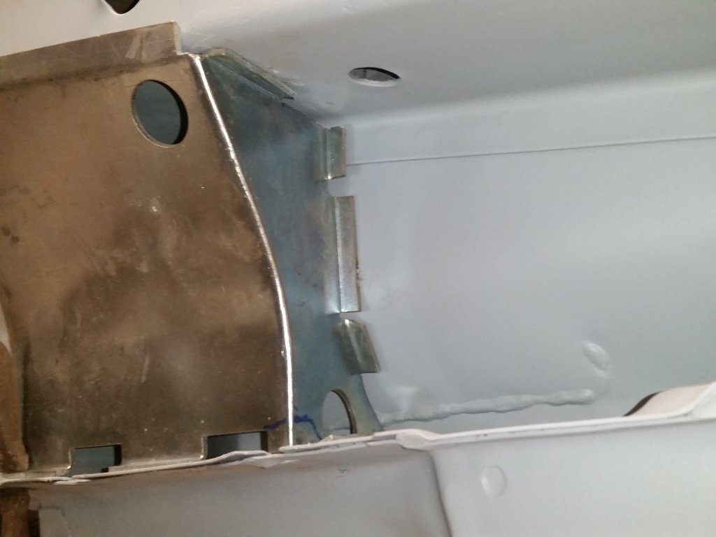

Post by 71Beeper » Sun Oct 28, 2018 7:39 pm
So after a bit of prep, I got the torque boxes welded in and put some primer on them.
Oct 14 (12).jpg (90.85 KiB) Viewed 28462 times
Oct 14 (13).jpg (52.77 KiB) Viewed 28462 times
Oct 14 (15).jpg (80.88 KiB) Viewed 28462 times

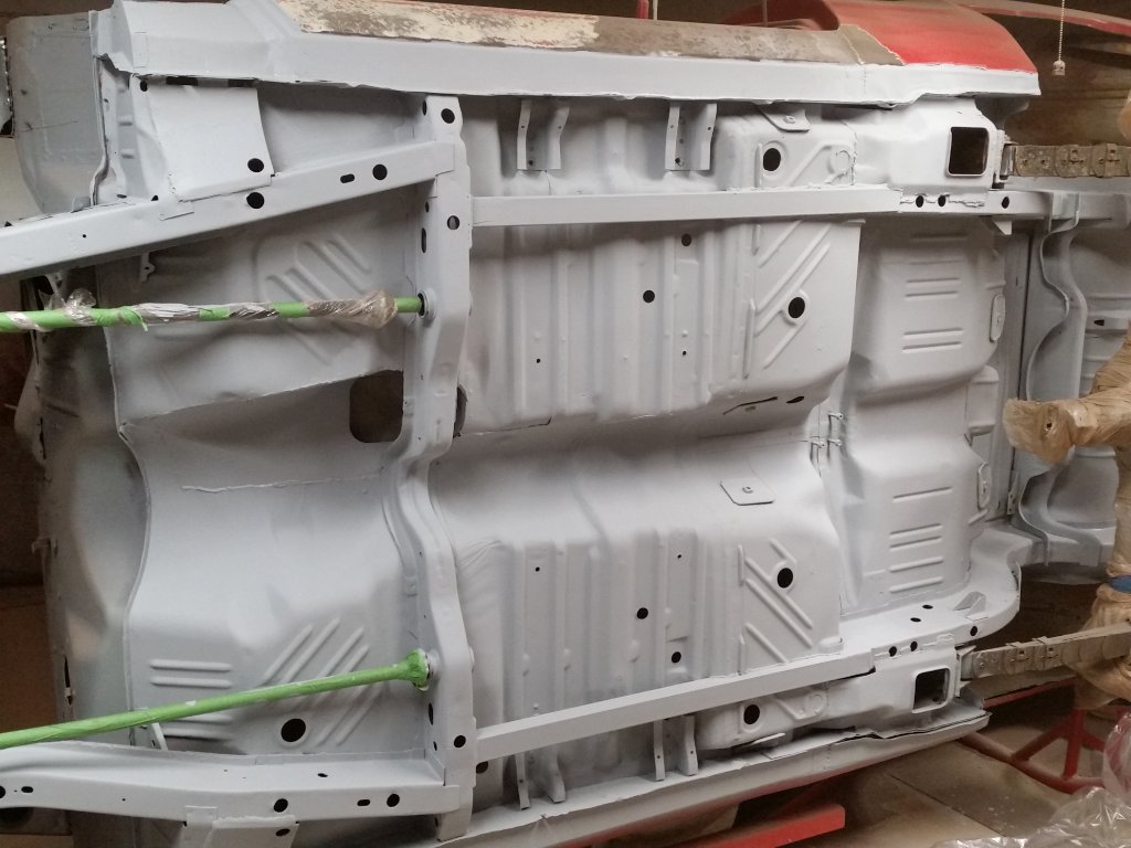

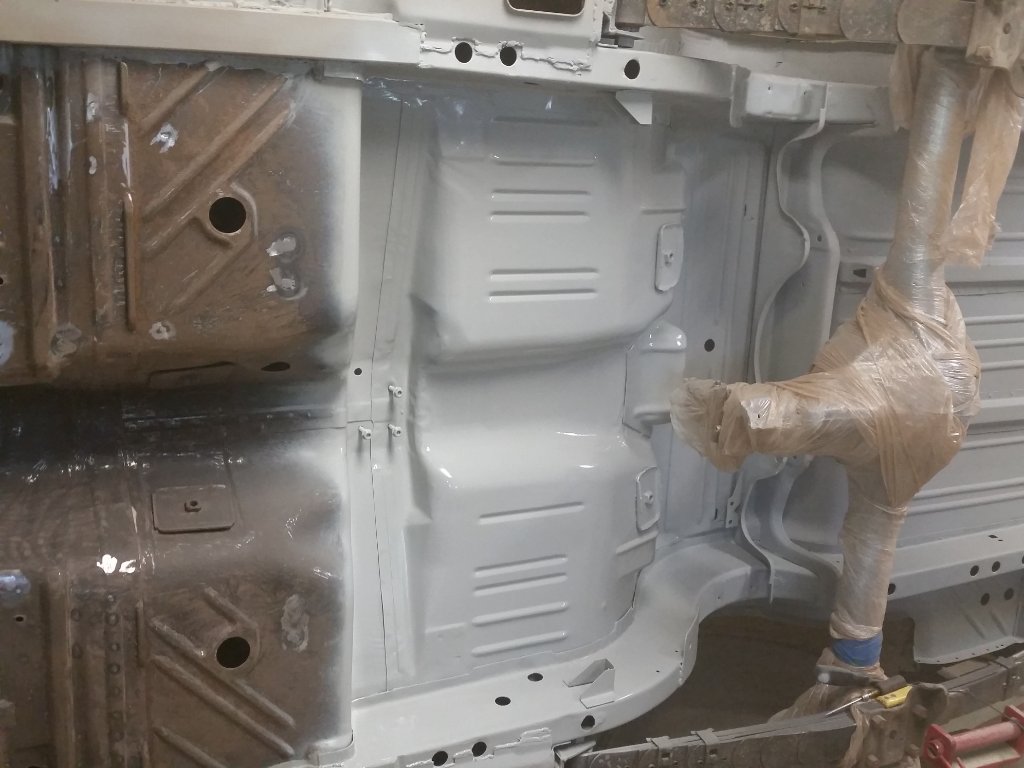

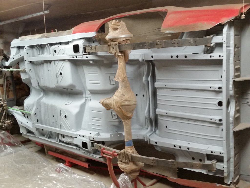

Post by 71Beeper » Sun Oct 28, 2018 7:44 pm

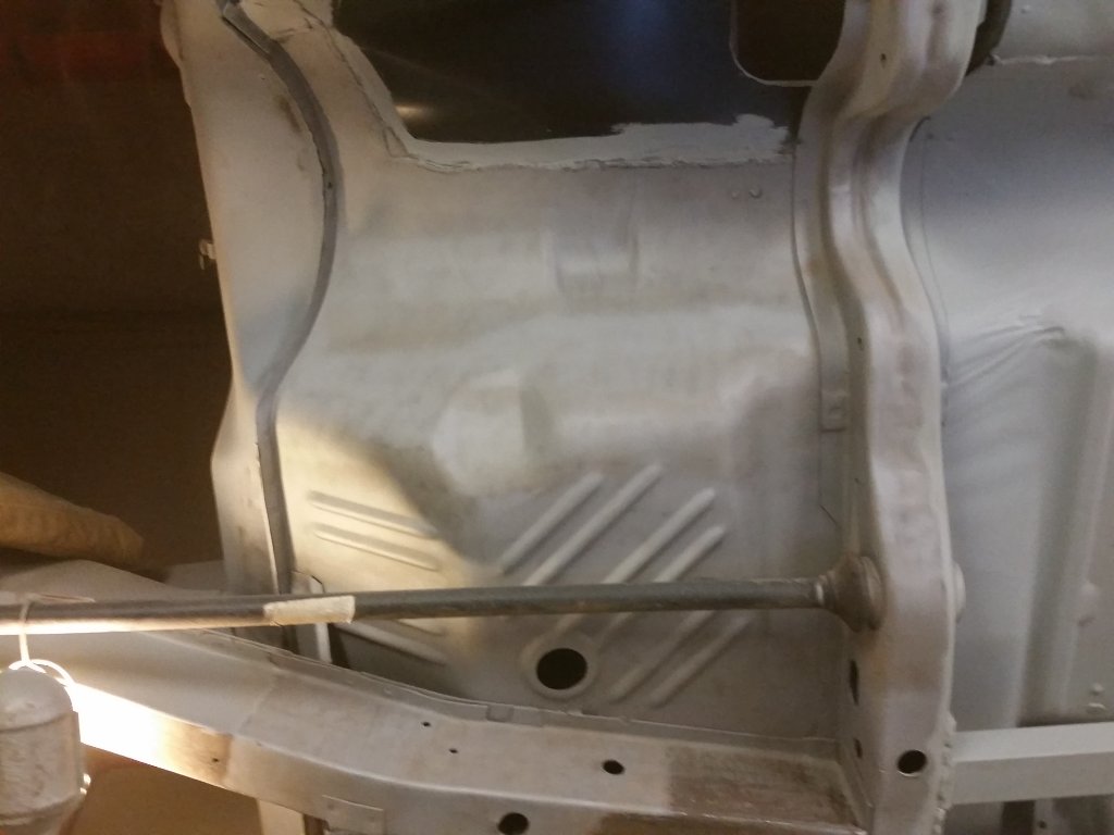

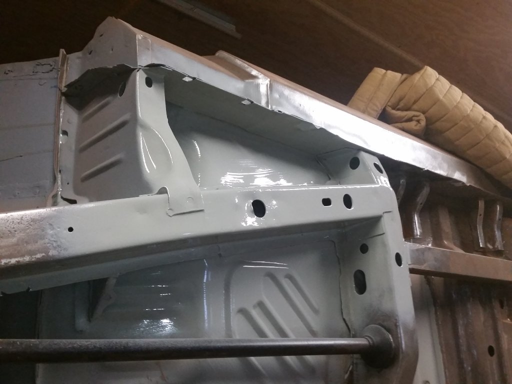

Finally I was able to scuff the whole underside and lay down 2 good coats of epoxy primer sealer.
At least the whole underside is now one color. :D
Oct 28 (7).jpg (113.87 KiB) Viewed 28462 times
Oct 28 (1).jpg (129.18 KiB) Viewed 28462 times
Oct 28 (9).jpg (123.57 KiB) Viewed 28462 times

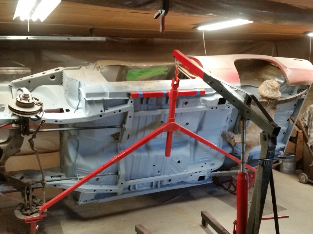

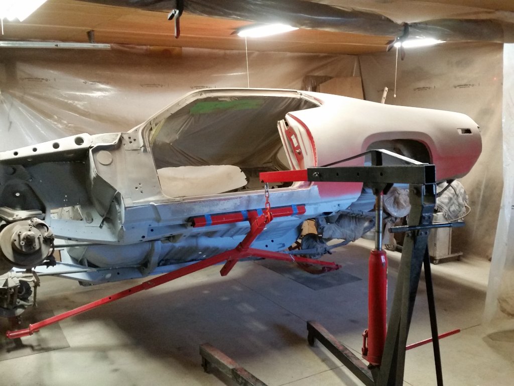

After this, I'll put two coats of regular primer on top of that and then she can come off the rotisserie!! :beer:
Checking my files - shes been sideways now for 1 full year........sheesh.

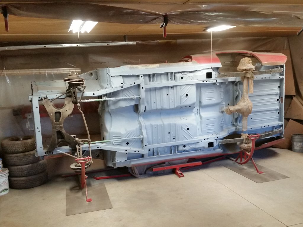

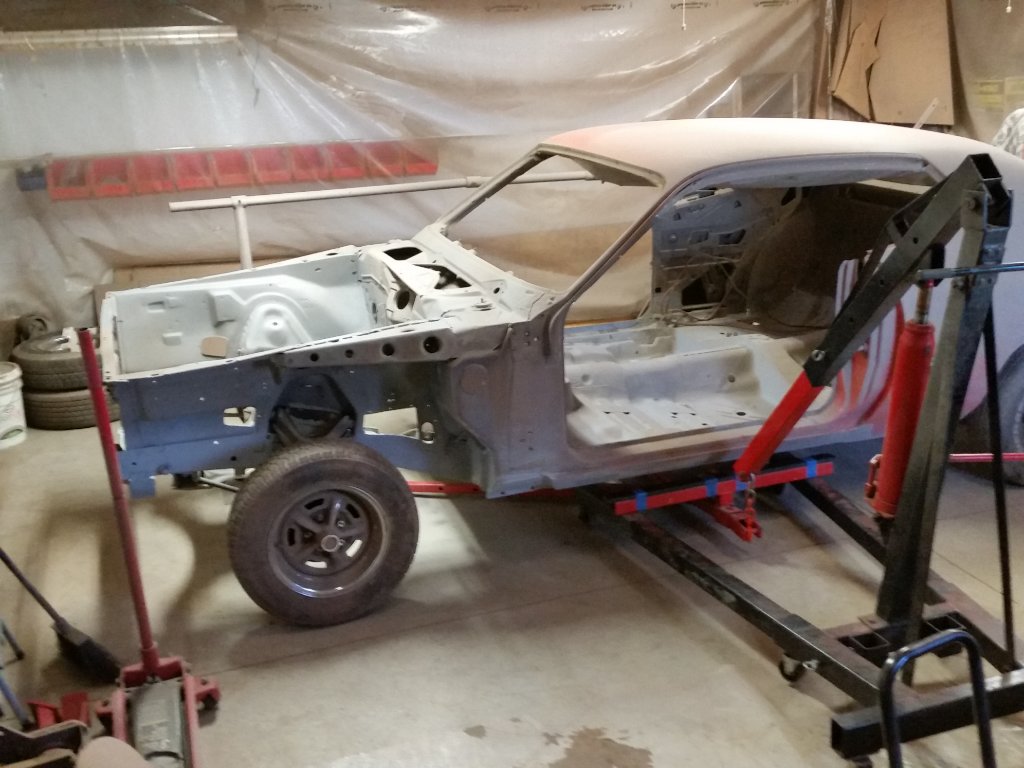

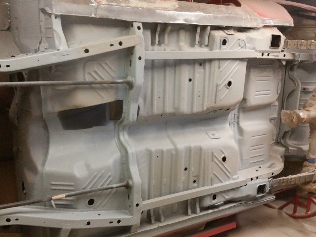

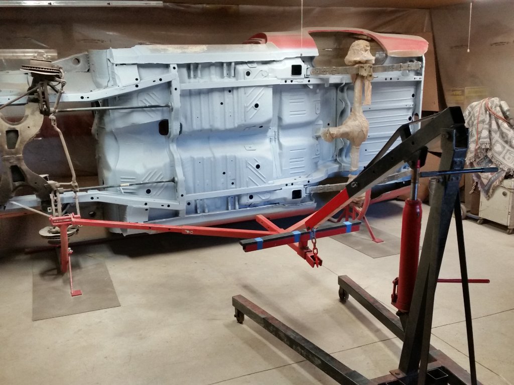

Post by 71Beeper » Sun Dec 09, 2018 9:26 pm
Well, I was finally able to get some work done today.
Now that she is all one color underneath.......
Dec 9 (10).jpg (125.62 KiB) Viewed 28161 times
It's time to come off the rotisserie.
Dec 9 (14).jpg (138.27 KiB) Viewed 28161 times
Dec 9 (16).jpg (125.5 KiB) Viewed 28161 times
Dec 9 (18).jpg (128.04 KiB) Viewed 28161 times
Dec 9 (19).jpg (117.64 KiB) Viewed 28161 times
The next step is to clean ALL of the glass bead out of her :shock: before setting her up on jackstands. :D

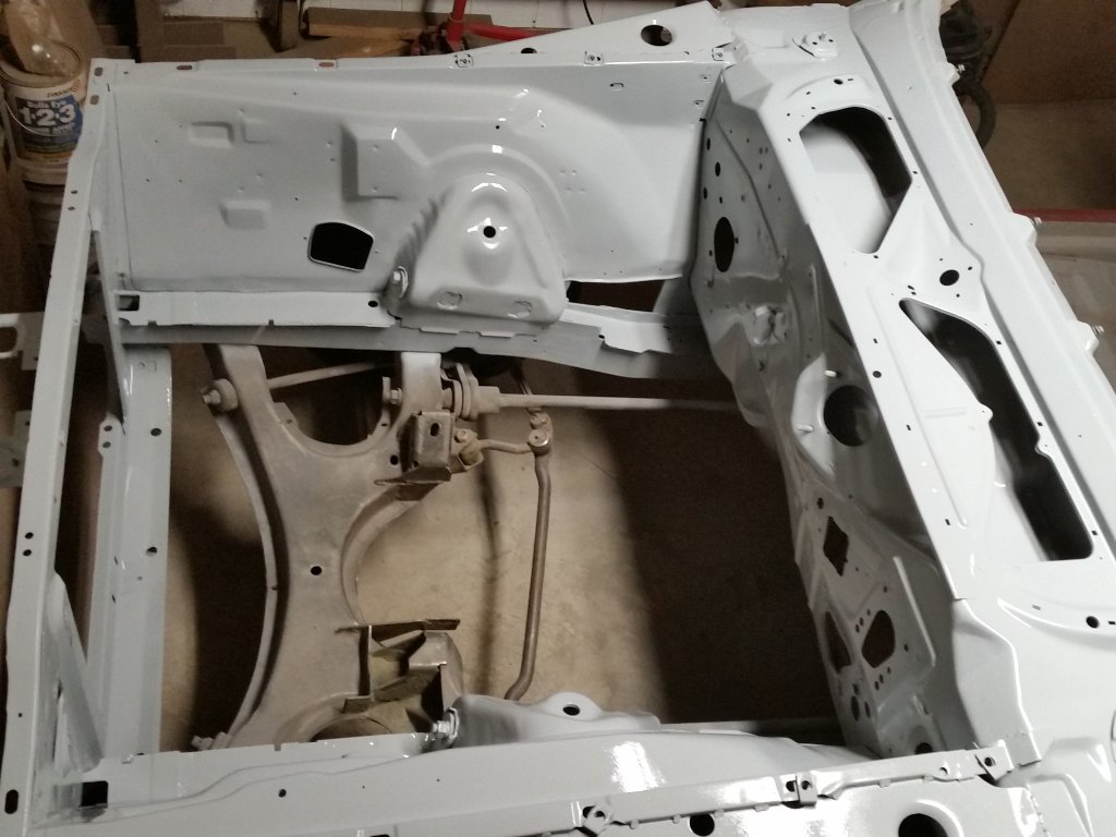

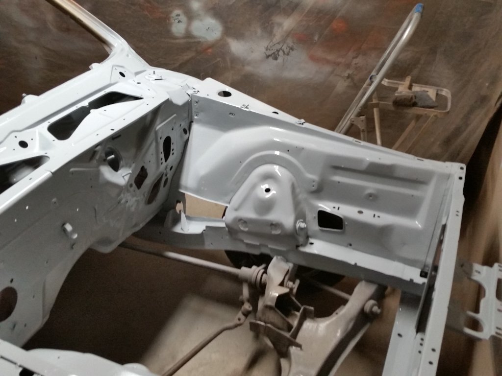

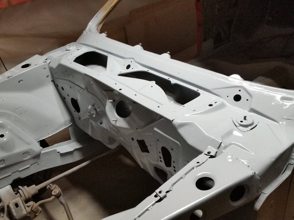

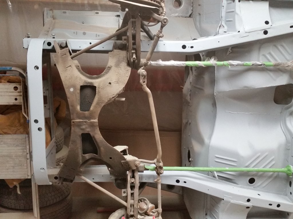

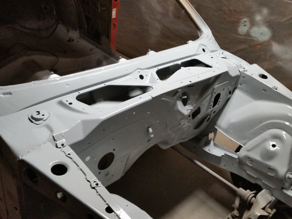

Post by 71Beeper » Sat Dec 22, 2018 6:07 pm

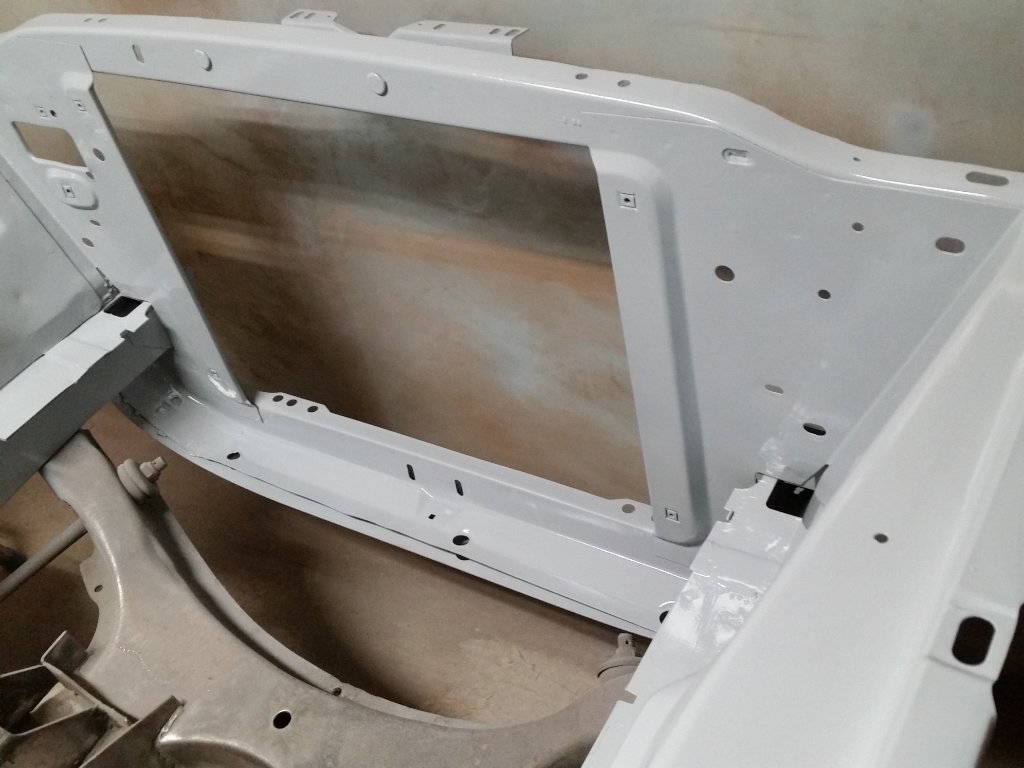

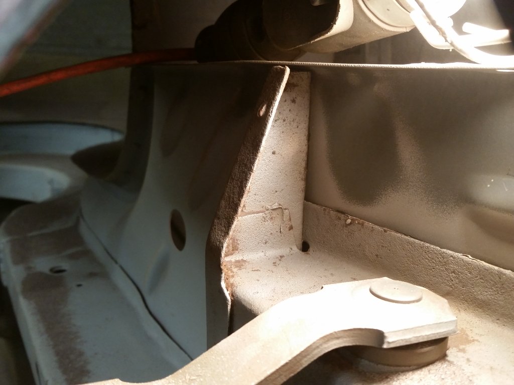

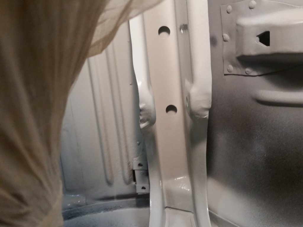

Because of the sandblasting and crap getting everywhere, the primer in the engine bay has discolored (I didn't cover it up before blasting).
So I scuffed the firewall and inner fenders and rad support & laid down a final coat of primer.
Dec 20 (5).jpg (102.64 KiB) Viewed 28084 times
Dec 20 (6).jpg (104.64 KiB) Viewed 28084 times
Dec 20 (10).jpg (104.66 KiB) Viewed 28084 times
Dec 20 (11).jpg (106.04 KiB) Viewed 28084 times
Dec 20 (8).jpg (88.78 KiB) Viewed 28084 times
