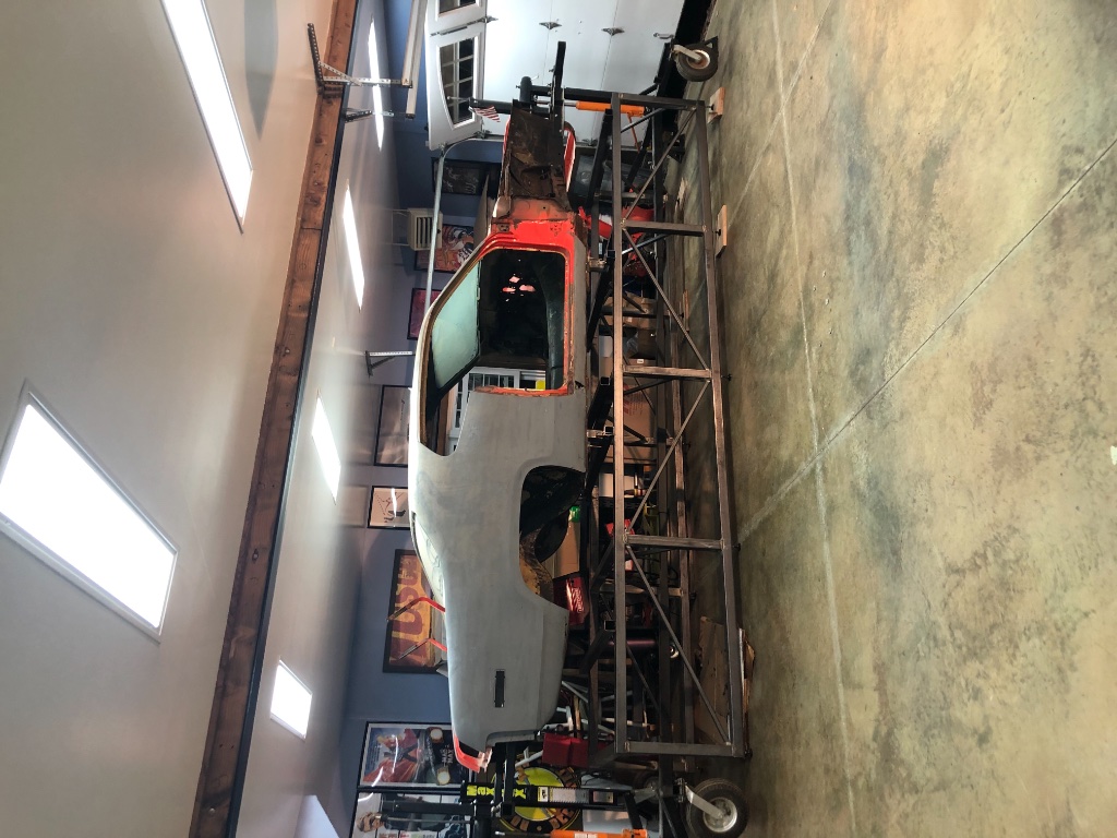

Post by ct71rr » Sun Oct 27, 2013 2:31 pm
Got the Bird mounted on the rotisserie:

Nice space and tools you should get some great work done

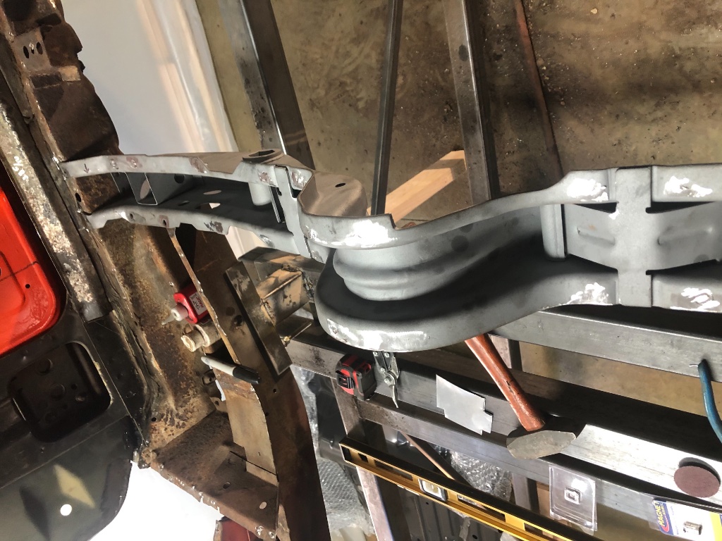

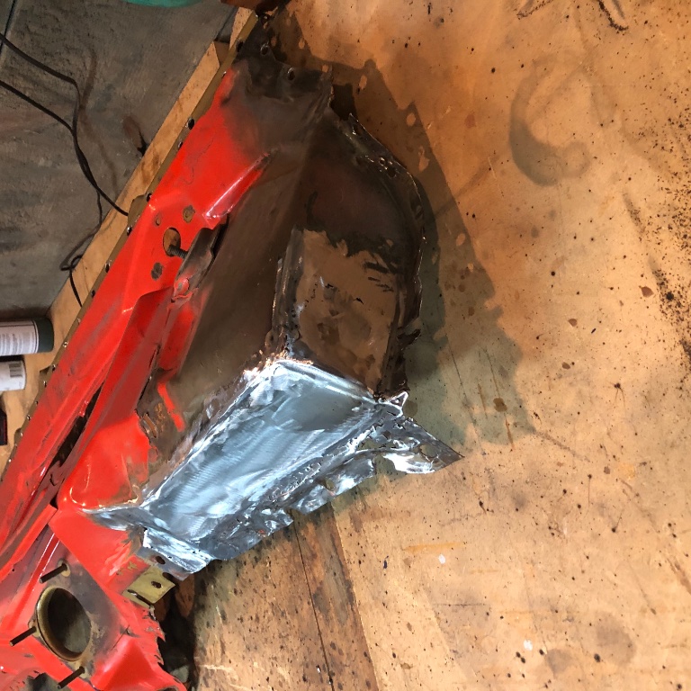

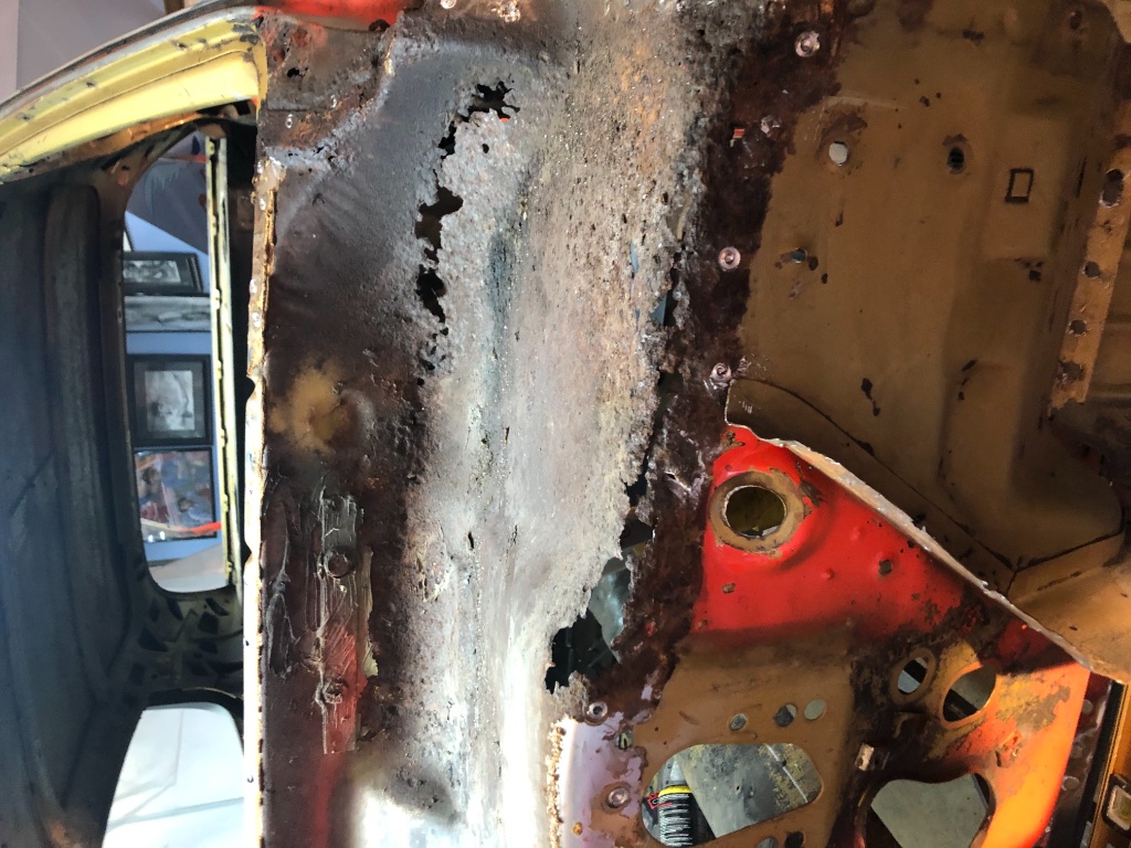

Wow! Over 7 years since I last updated my thread! I guess that’s what happens when life gets in the way of our hobby. I finished up my garage and an addition on my house and a bunch of other stuff. I also started working on my Road Runner:

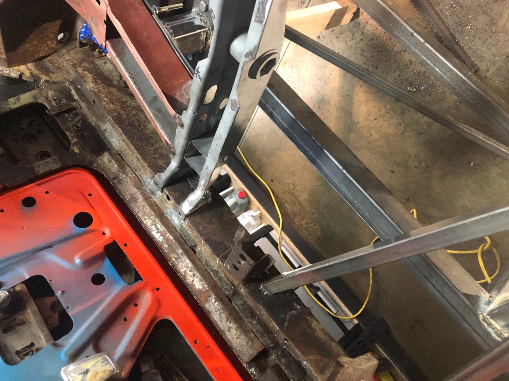

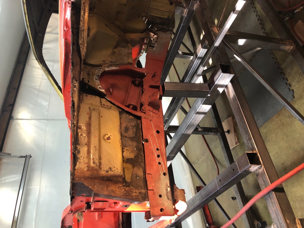

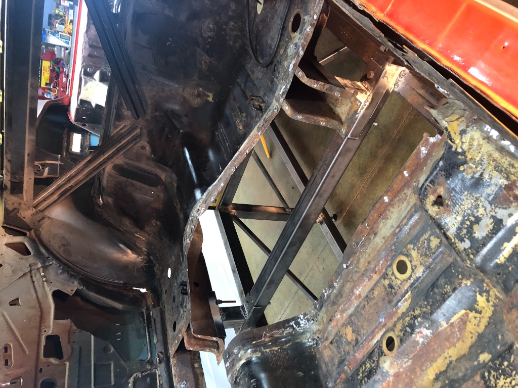

First order of business, replace the rotted driver’s side frame rail. To do this, I removed the floor boards which were pitted and dented and will be replaced too:

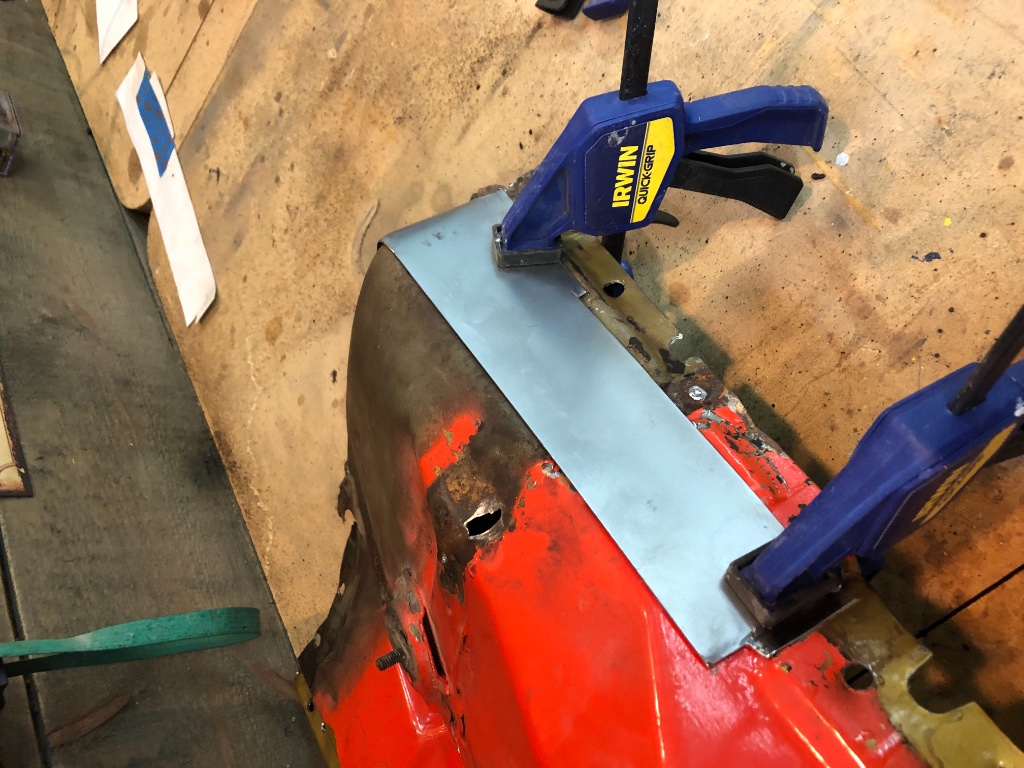

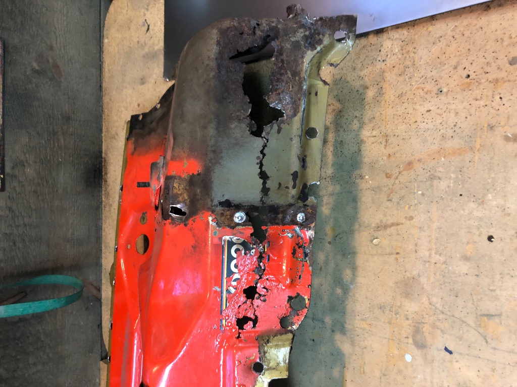

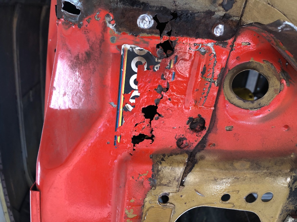

After getting in the frame rail, I started looking at the back driver’s side section of the firewall that needed to be replaced. Originally I was going to patch in a piece to fix the area. Then I decided to remove the cowl for a better look. The cowl was also showing rot. Good thing I did, the top driver’s side of the firewall was toast. Sooo...that came out too:

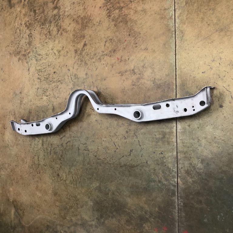

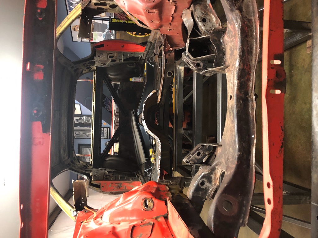

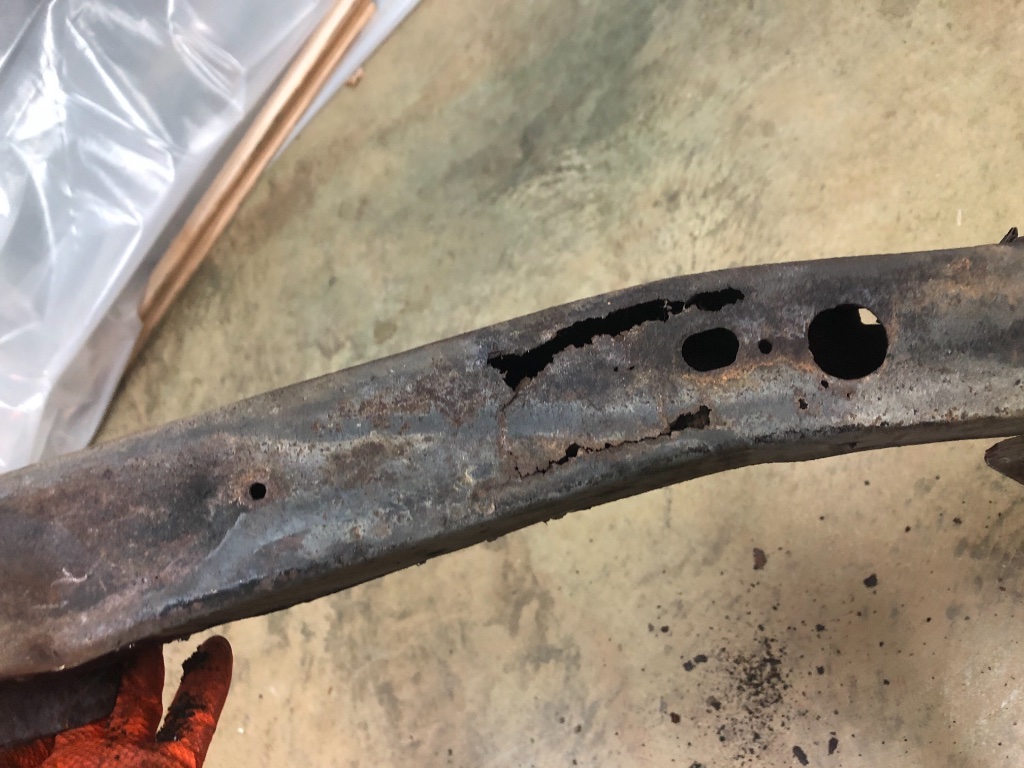

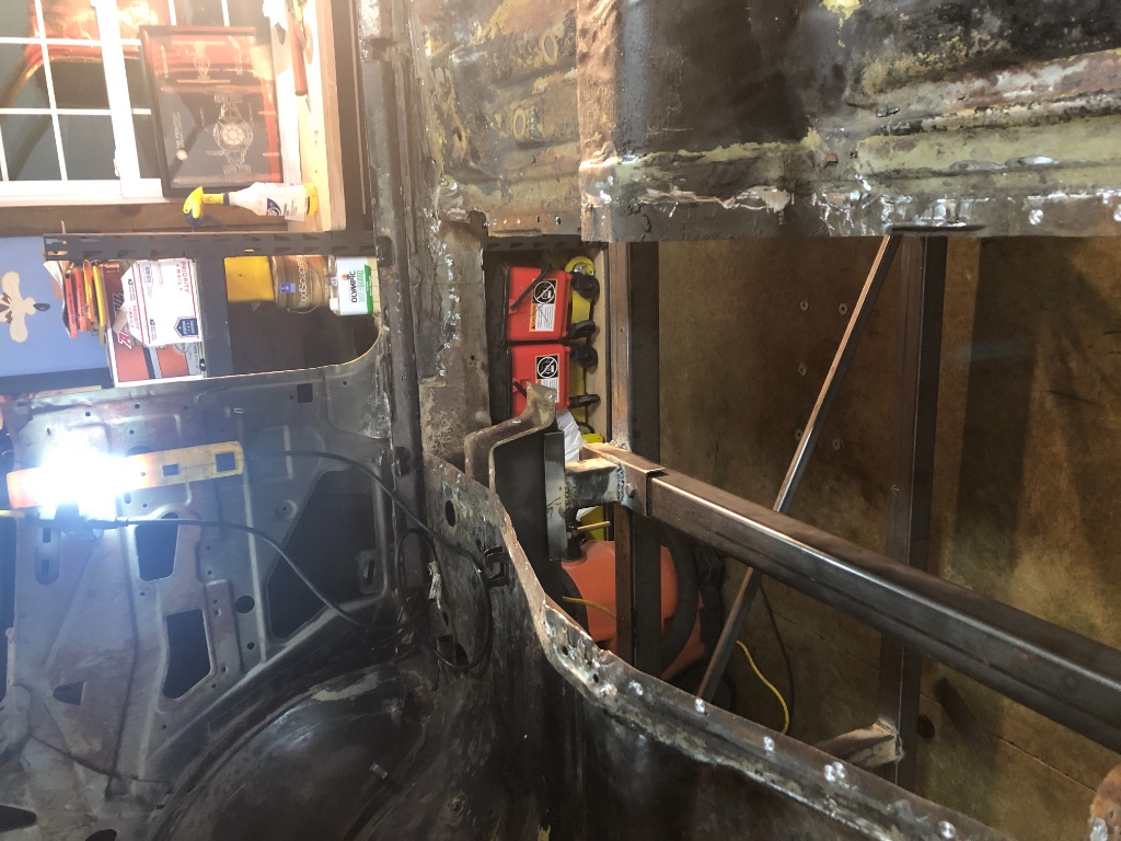

I also found some rot in the torsion bar crossmember. I’m in the process of repairing that now:
I was not expecting to find this much rot.
I’m not sure why my images are showing sideways?!

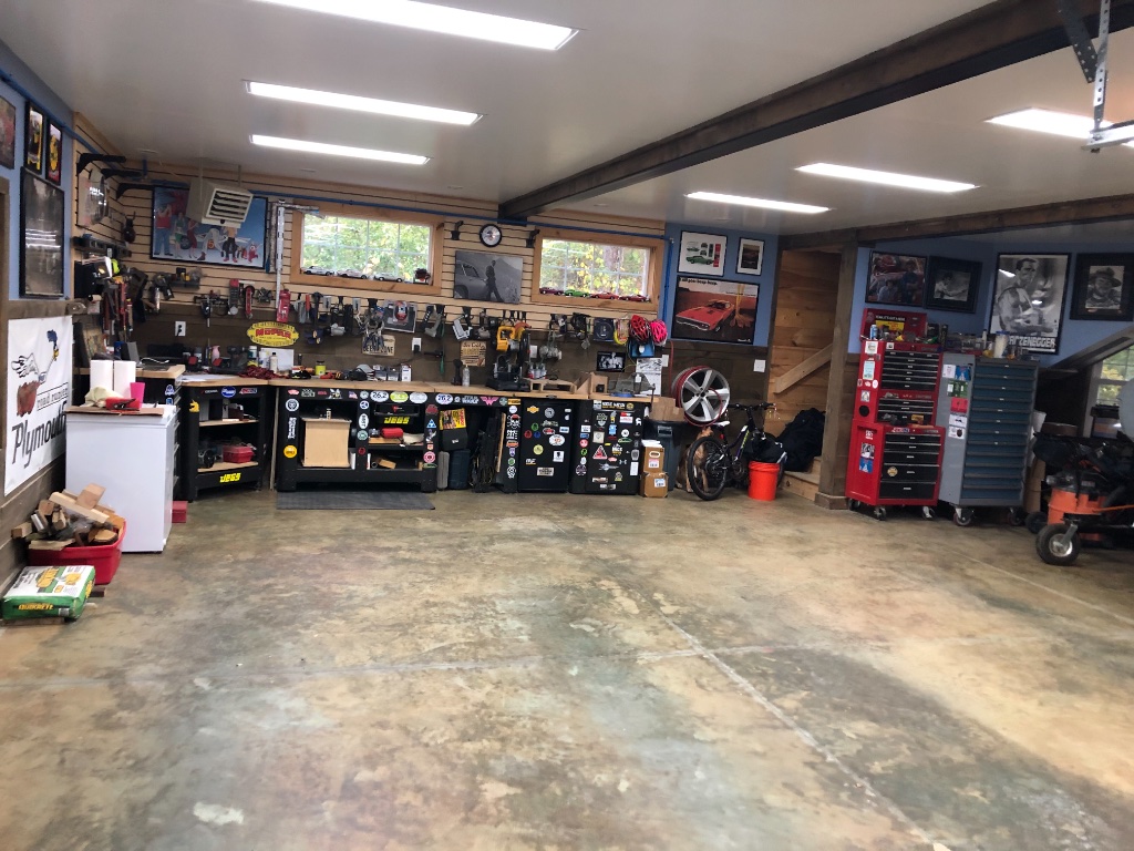

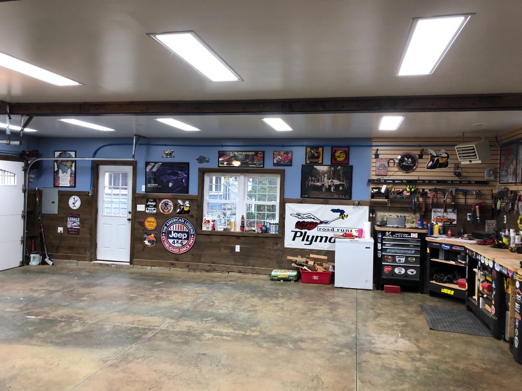

And my completed garage:
Re: sorta new
Post by sdweatherman » Sat Dec 05, 2020 12:22 pm
Awesome space! And it looks like you have a lot of work ahead of you on the RR - damn rust! Looking forward to updates on that well optioned Runner.
