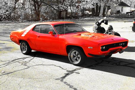

Speechless...WOW! Thats a great RR! :beer:
