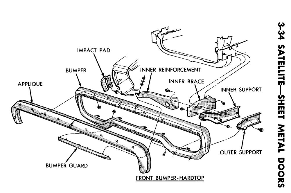

Aformentioned gap on my car is about 3/4", which I think is larger than it should be. Looking at the FSM, it would appear the major attachments are on the lower part of the hoop, attaching to the supports. To close up the gap all the way around, you would need to move the supports backward. To close up the gap only at the top, the bumper would need to be angled back somehow. The FSM also shows what they termed "impact pads" attached to the fenders which seem to support the sides of the hoop. Not sure if these are attached to the bumper also or have some sort of profile interlocking fit?

The impact bumpers are only attached to the fenders. I can't remember if there are slotted holed for fore/aft adjustment but don't think so. There is likely a gap between the backside of the bumper and the impact pads so they wouldn't be holding the bumper out.

Neither the impact pads nor the lower bumper brackets mounting holes are slotted. However, the brackets themselves should be slotted, allowing for that fore & aft movement. I am planning on doing the exact same thing, trying to close that gap up also. As soon as my bumper gets back from the body shop, i will be attempting this modification. ill keep ya posted as to what i find.

I just installed the bumper on my 71 night before last. There is enough play to slide in and out and tilt up and down. I knew it would be a "challenge" going back and forth with the wife so I snugged the bracket to frame bolts in just enough the keep each adjustment in position while doing so solo. Initially I wanted a fairly tight gap on the top side but that left a huge gap between the lower valance and the bumper. I was able to adjust the valance up and in somewhat which made a big difference but in the end the final gaps were achieved by "splitting the difference".
