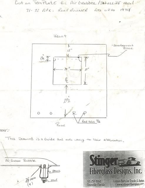

I know I've seen it here before. I would like the template to mount the air grabber bubble assembly. Can someone post it.

I hope this is what you need.
http://i18.photobucket.com/albums/b133/ ... tinger.jpg
Dimensions are a little hard to see, so here goes;
cutting lines
-15" from front of hood
-21.5 inches from the back
-the hole is 21" long
and 18 " wide
after you cut out the skin, 1 3/4" of the reinforcement brace should be showing at the front of the hood.
The holes at the rear of the hood are suppose to be 7/8ths of an inch. Mine had to be a little bigger.
Good luck,
Dennis
