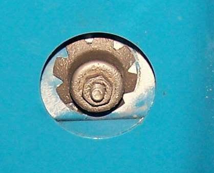

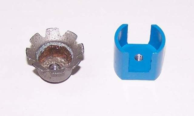

I also made a set of fastners to replace what I call the "fluted thimbles" that screw onto the studs to hold the callouts on the hood itself. They are machined out of aluminum stock and are cut in such a way as to let any water drain out. This was the problem of the stock ones...they trapped water which is why the studs rusted off.
Here's the new and old attaching hardward. (top and bottom views)
Here's what it looks like painted and installed. No, it's not "correct" but then I didn't restore the car with that in mind. I made a lot of "improvements" and this was one of them.
This is what the original attaching "thimble nut" looks like. At the time they were nearly impossible to find. I saw one set on eBay for a couple of hundred bucks and they were not exactly like the ones I took off although the were claimed to be "original". The tops were not fluted like mine. I knew mine were original as I was the car's only owner and they had been on until I started the restoration.

I originally looked at that, but they are actually two pieces. The "thimble" then the nut. The thimble is a press formed piece and the nut is swaged into the bottom. Which is why I went with the turned aluminum piece. Just chucked it up in the lathe, milled the sides, tapped the hole and presto!
Originally I didn't have the sides cutout and first time I washed the car I saw the water drip out so I cut them so it would drain.

As I said, check very carefully the depth of the hole in the horseshows compared to the length of the screw in portion of the stud. I found a large variance in that between studs. Like up to 1/4 of an inch! I simply used two nuts locked together on the machine screw portion (10-32 I think) to screw them in.mopar71 wrote:Nice mod! so I will take a trip to Lowes for the studs and will have to mod my own fastener. Have a milling machine at work!
If you want I can measure the aluminum "cups" and post the detailed measurements here.
