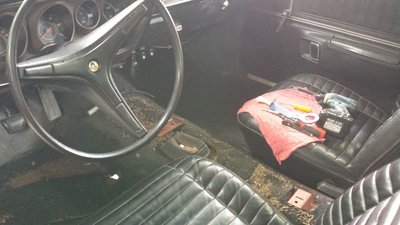

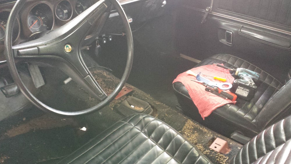

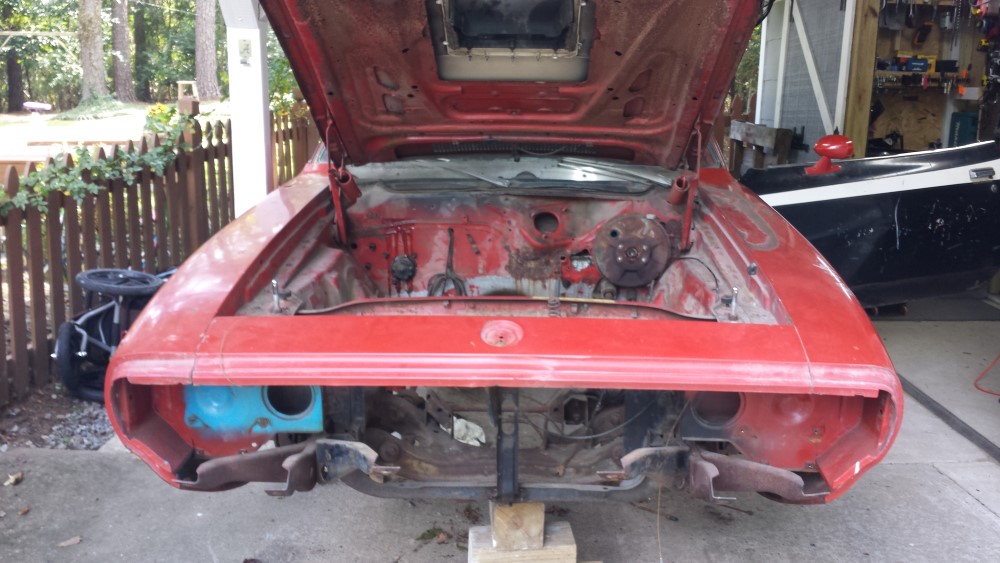

Hey just wanted to post a quick update. I have a friend who owns a restoration shop and I am going to have them do the blasting, body work, and paint. I will probably have them do the engine also later on. Given the rust on the firewall and hearing some stories about old wires, I decided to strip it down to the frame and hopefully do it the "right way" and replace the wiring harness etc. I am knee deep with it now and have removed the rest of the brake/fuel lines, bumpers, grill, etc. I am also pretty well along removing the interior trim, console and am about to take the dash out.

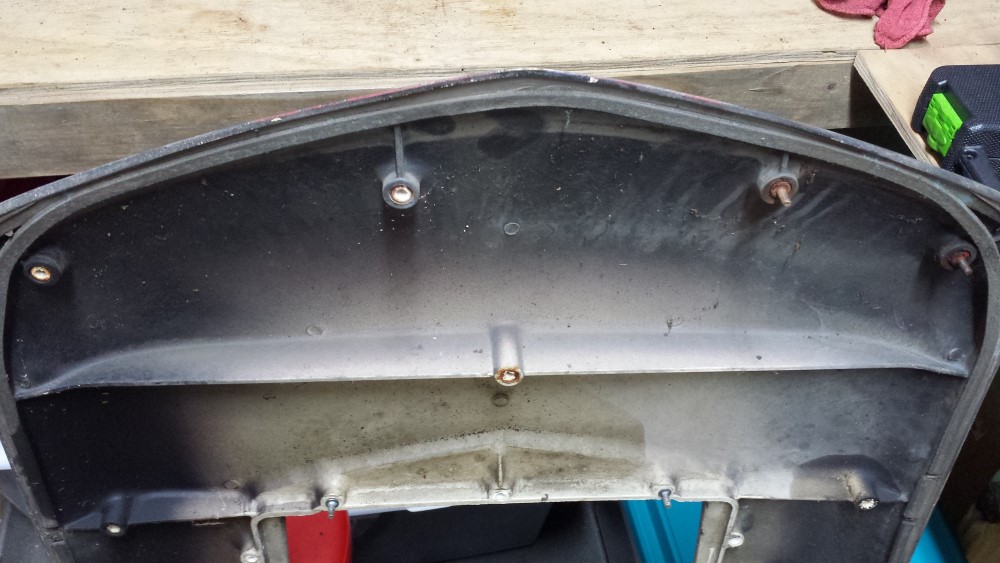

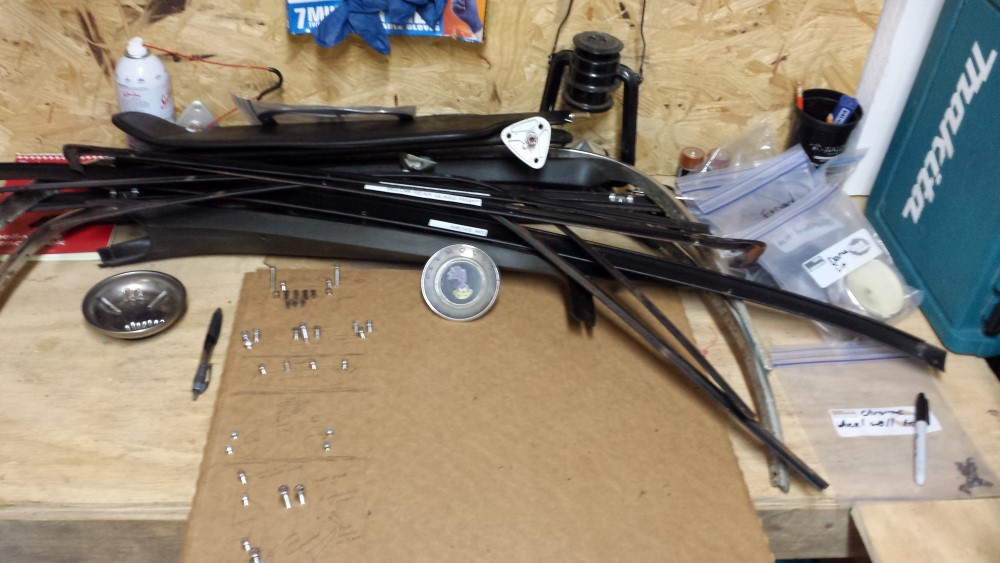

I removed most of the air grabber parts but I am having trouble getting the nuts off the studs in the air grabber. About half of them have spun/stripped out on the plastic air grabber side of the stud while the nut stays frozen on the bottom side even after sitting in PB Blaster for several minutes. Hopefully I can just fill and retap the plastic holes when it comes time to replace this. But I want to get it all stripped down for the blasting/painting.
So, hopefully I am a few dozen work hours away from getting it sent off for blasting and body work. Any other pitfalls I should be on the lookout for while stripping the interior and as much of the body as I can? I am going to leave the suspension adn steering wheel on it to get it to the shop and then probably just let them do the suspension bearings/bushings for me while they are getting it ready to sandblast.

I guess in reading the way I posted that, it might sound like they would sand blast it after doing the suspension. It was just one of the last things we discussed, but they of course are not going to do things out of order like that. I was thinking that they could just remove the suspension and work the bushings, etc. and with the suspension off they could sandblast the rest of the car - basically the frame only. Since I am going to have it all the way to the frame, I guess I should consider the rotisserie option? Any thoughts on the pros/cons to that?

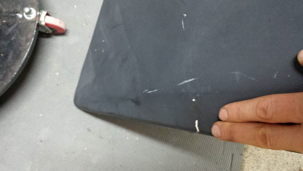

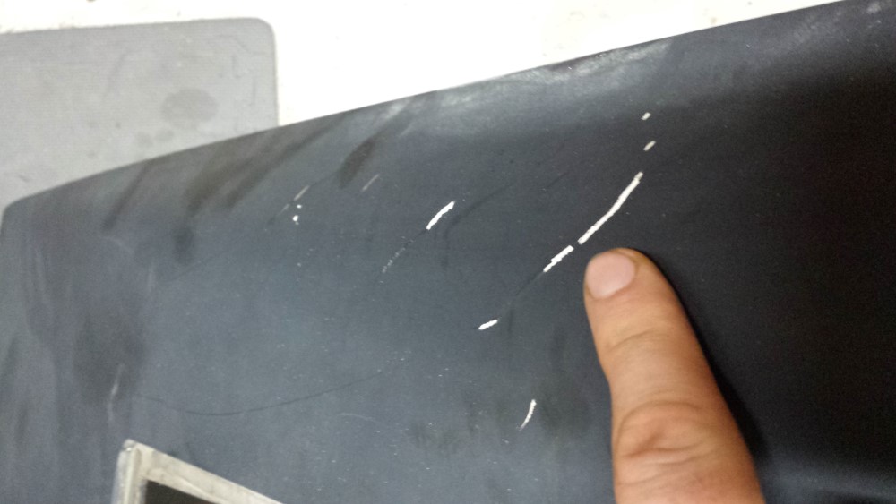

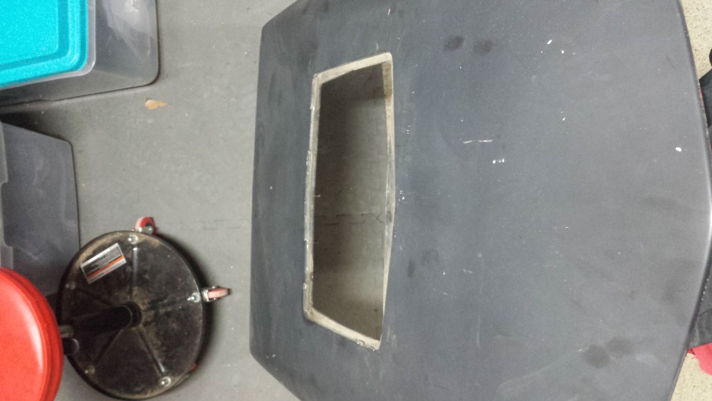

Thanks for the tip on the air grabber. I got the air grabber hood off today, and only 2 or 3 of the studs remained in the fiberglass (referred to in Alabama as "plastic" LOL). Most of the studs stuck in the hood came out with a grab from the pliers, but two of them were extremely stubborn and made it a few turns before totally locking up. It seemed like the nuts were cross threaded and it was a pain in the ass getting them out; I finally had to drill both of them out.
It looks like he had a few relatively minor gashed in the fiberglass from years of using the top of the car as a tool/junk storage and sorting location. I suppose fiberglass imperfections can be patched and repaired?

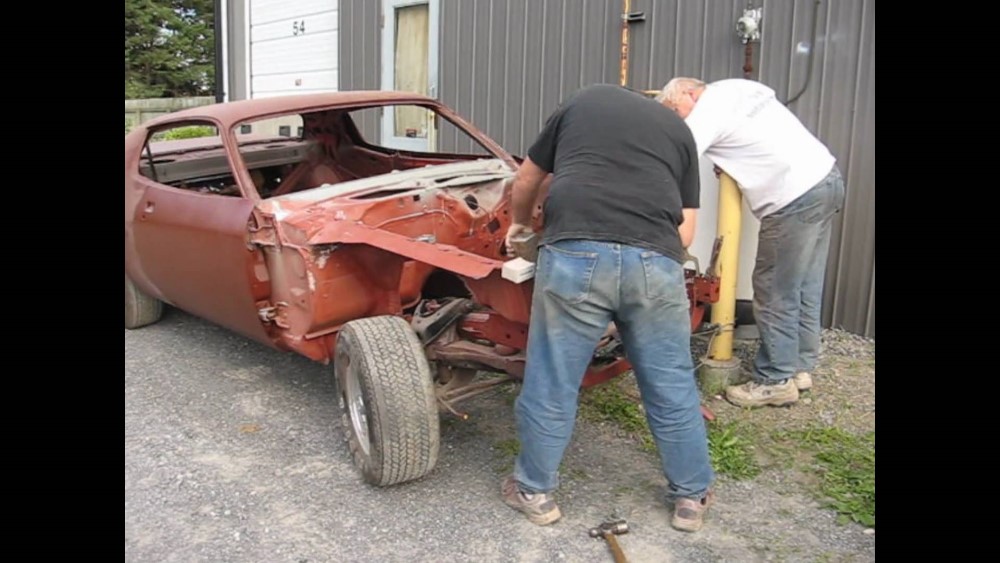

I'm probably just not using the right terms, but I left off with the shop that I would strip the car down as much as possible to save on labor, and then wheel it on down to them with nothing more than the wheels, suspension, and steering box still attached to the frame/unibody. From there, they would blast the entire thing - interior, exterior, bottom frame, suspension, etc. Kind of a poor mans rotisserie to save a little money. They would then fix the body and frame rust, and paint the bottom with bedliner or POR or something and paint the rest in primer for the time being until I saved up for final paint.
I was going to do the suspension bushings my self after all this was done, but they got to talking about how I might just let them do the suspension since it would involve cutting torches, presses and some other tools that I might not have. For a few hours more of labor, it seemed to make sense to let them do that so when I got the car back, I could jump right into the electrical harness, brakes, fuel system, and reassemble the interior. Haven't even begun to work out details on the drive train yet.
Basically, I envisioned sending them the car looking something like this (pic I found online):
