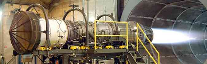

Our cars have way too small wheels and gears to go really fast. If you do some math at 100% efficiency, 3:23's put you at about 140mph@5500 rpm. Now factor in wind resistance and a 25% loss of rpm with an old non-lockup automatic, 140 seems hopeful. If you drop it out of a plane at about 30,000 ft that would be your best chance of hitting 200. Or just install the engine in this photo, that should do it. Oh yeah, a 383 will hit 6000 rpm all day long!
