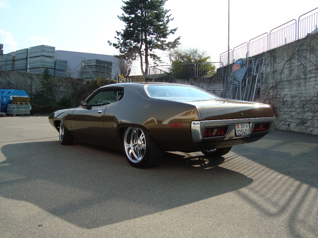

my RR has 19x8 on 245/40-19 and 20x10 on 275/40-20, all with offset 7mm...and no body mods...
- RunnerHomepage4.jpg (363.89 KiB) Viewed 18702 times

That car must really turn heads. I can see the young guys going nuts over it. "WTF is that!"

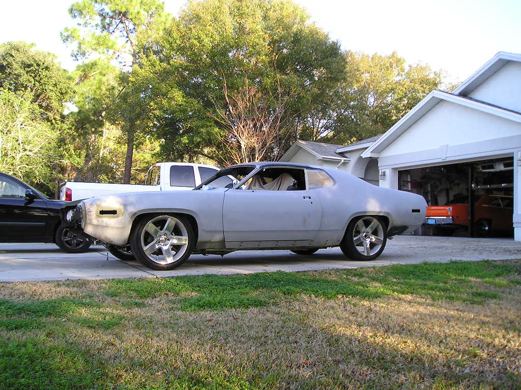

rmj wrote:Back from the dead! This is a REALLY old pic. 18x8 and 20x8 Centerlines. I don't remember the front tire size, but the rear is 265/50/20 BFG KDW 2's .
Gionni, back before your airride, did you have your springs moved in to hold the 20x10's?
These are pretty close to the springs now.
It has a 380 hp crate motor with march serpentine and sanden a/c. Factory metallic green interior.
Fixing to remedy the interior with something like Gionnis.
Gionni, was it hard covering your dash in leather? (I'm thinking ofdoing my door panels and console too.)
Thanks
Richard Milne
wow, nice satellite man! do you have more pics?
no, i never moved the springs in...the 20x10 mit 7mm offset fits without mods on springs or on body!
the covering of the dash in leather was a hard job...and it needs streching leather..like the orginal material of factory cars. mine is from BMW...
