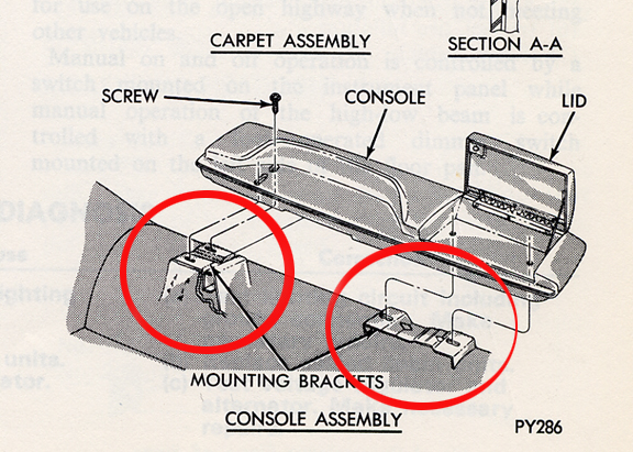

Post by bruce » Wed May 03, 2006 9:04 pm
Looky what's in the service manual. Okay, it's for my '71, but you'll be looking for any '71 and up console (although a '70 will work too). In the red circles are the brackets I was talking about. Unfortunately the generic floor in this illustration doesn't help a BIT as to the brackets actual location on the hump...

Post by bruce » Wed May 03, 2006 9:37 pm
Oh, and notice the slotted holes in the brackets where the screws for the console mounts. Obviously the location of these brackets wasn't an exact science... I just sent you an email cuz I'd love to see pics!

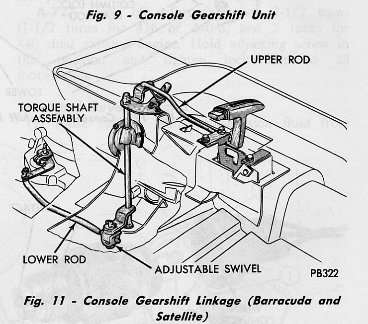

Here's the FSM illustration for the floor shift. Notice where the boot attaches to the floor on the "torque shaft assembly". That's where the circular stamping on the floor is for the shifter. That's probably the key to locating everything for you.

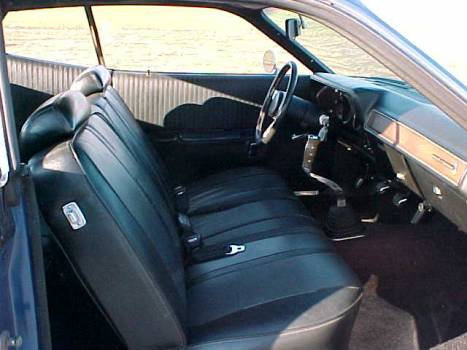

Hey...bench seats in big block cars are very cool....here's mine...if I were you, I'd think about going back!
