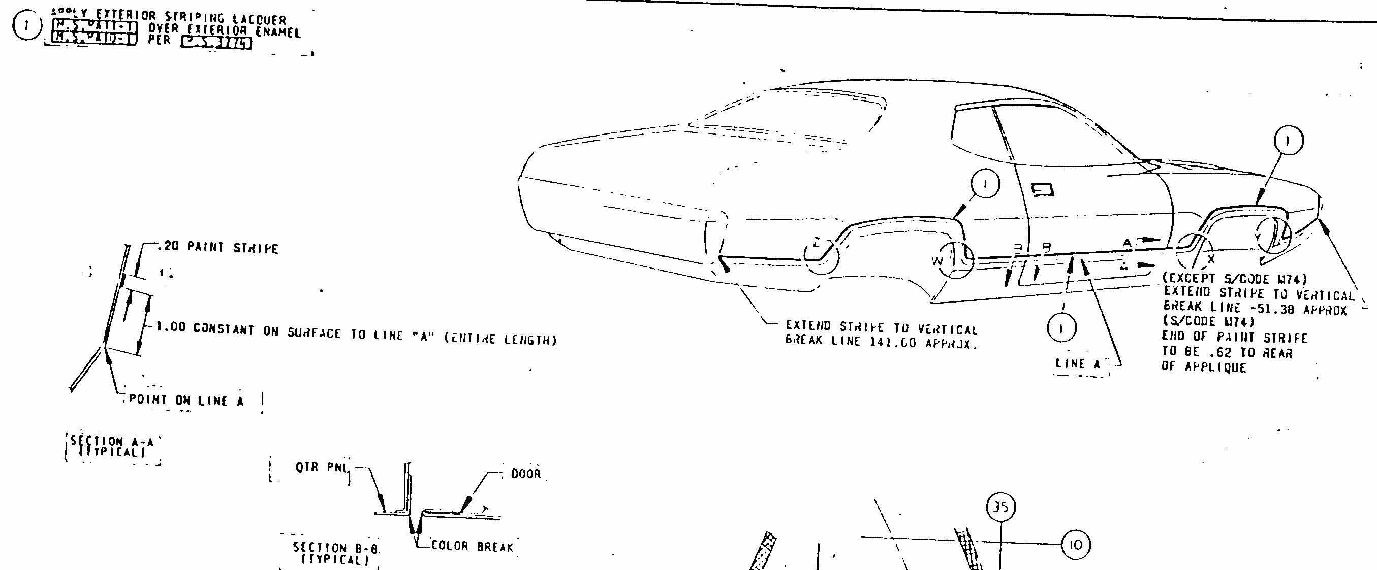

The V7_ stripe is the pinstripe standard on all 71 GTXs that was PAINTED on and ran the length of the car just above the body lower character line. You could do it with standard pinstriping tape, but it would not be factory correct. I believe I do have the factory document that shows the spacing.....I'll see if I can find it.
Here is part of the V7_ stripe factory engineering illustration from 10/13/1969. Note at top calls for the stripe to be lacquer.

The diagram above is correct....I was told once by a fella that the painted pin stripes were put on using some type of teplate at the factory....using a formed edge that the stripe wheel rolls against.....similar to the pin stripe roller and magnetic trac kit you can order today......

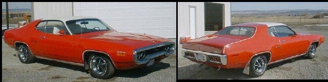

Not to throw a monkey wrench into this thread but I guess there are always exceptions to the rules....
Here is my 71 GTX with the original stripes still on it.... I have additional pics but the flash was in the way....

the painter was drunk that day

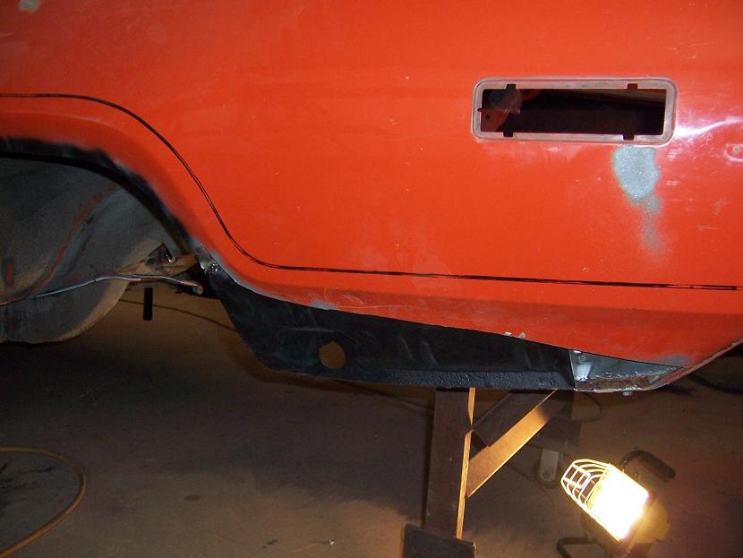

just for reference
