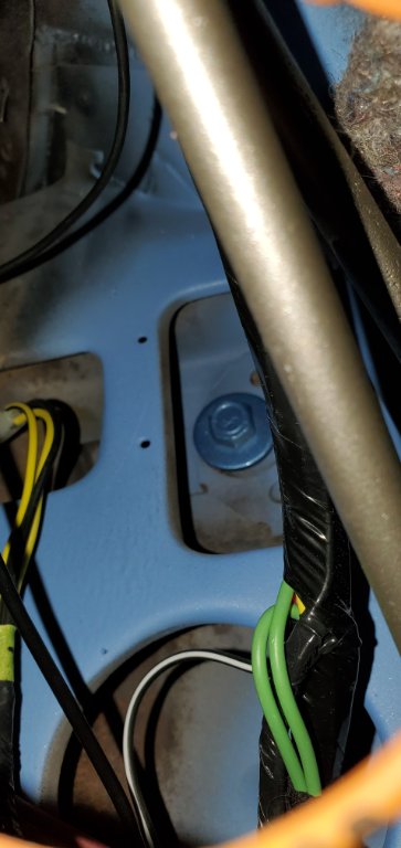

Hello everyone. I am looking for info on where to locate the headlamp time delay relay and also the reminder buzzer. I know they were separate options but was it possible to order both simultaneously? I have a 3488391 relay & bracket assy. I found these screw holes in the LH side cowl near the door ajar switch but the spacing on my relay is wider. Am I in the wrong area or do I have the wrong relay bracket?
- 20210907_101749.jpg (45.02 KiB) Viewed 44636 times
- 20210907_102623.jpg (45.24 KiB) Viewed 44636 times

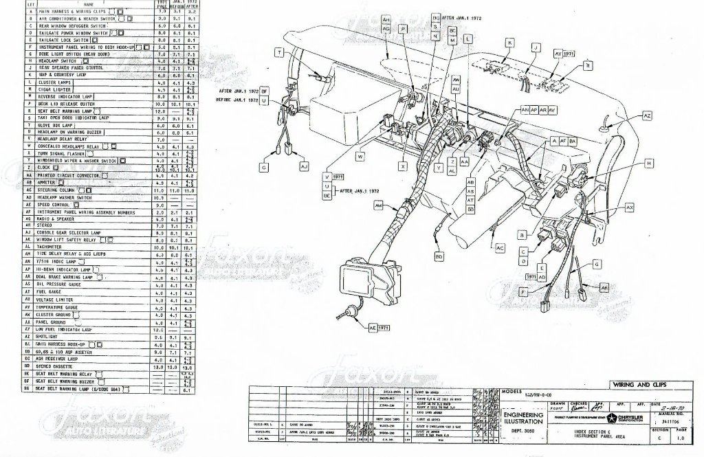

Not sure that’s the correct delay relay (U) for a ’71 B-body, bracket does not look correct for a mounting where the diagram indicates. I know in ’72 the lights on buzzer (U) is located there as well as the seat belt warning relay (BE), again this engineering diagram indicates only after Jan ’72 for the lights on buzzer.
