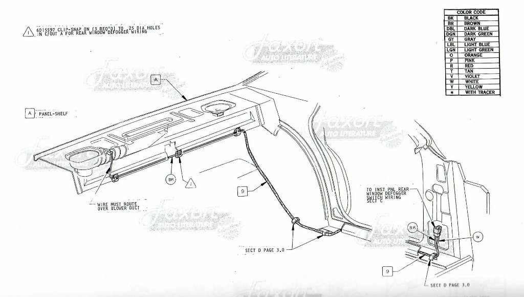

Of the three possible locations, was there a rhyme or reason to which switches were mounted where? I selected the left most position for RR defogger switch. That is the only switch I have. Also, can anyone post a photo of the wire routing under the package tray. I believe there are 3 clips. Finally, anyone use the repop plenum from Classic Industries for use with both defogger and speaker? How did it work out?

Hey Tyler, you seem to come up with some of the toughest questions for us. I looked through my disassembly pictures and could not come up with a shot that has any clues on where the defogger wiring or time delay stuff is mounted. Hopefully someone else will have some insight on this. Good luck!

- defog.jpg (91.52 KiB) Viewed 38024 times
