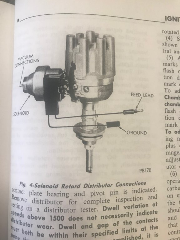

I am trying to find out where and how the "FEED LEAD" and ground wire are routed on my 71' RR 440+6.
It show the wires in the factory shop manual but does not show as to how they are routed or to where their respective connecting points are.
This car is a late production LA built with California emissions.
Pictures are attached of the distributor and the photo in the factory shop manual. Hopefully someone out there will have a picture or a descriptive explanation as to how these wires are hooked up.
Thanks a bunch
