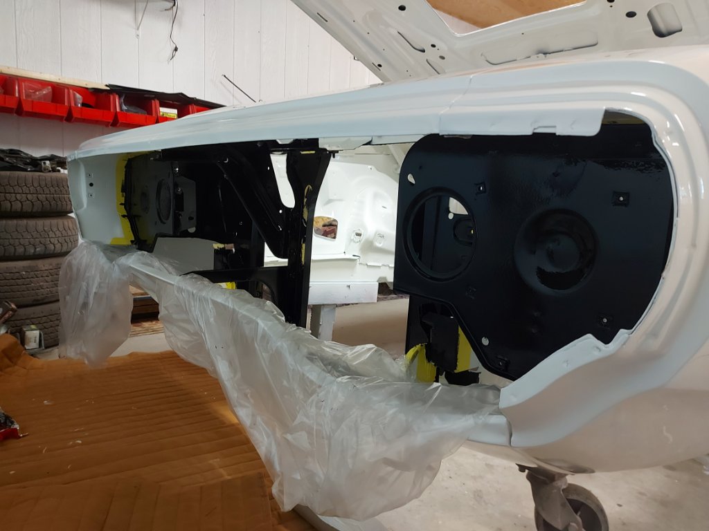

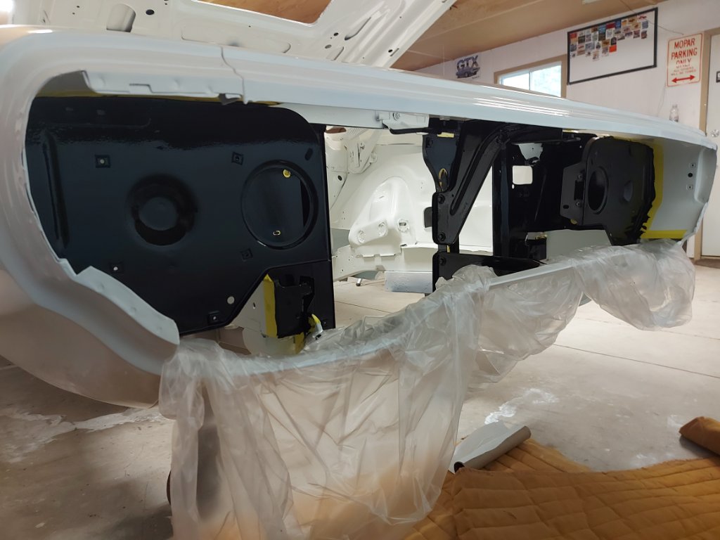

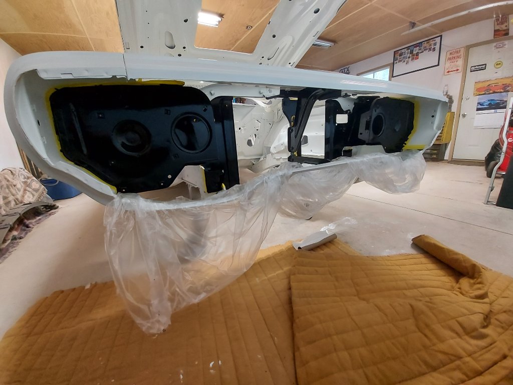

Post by 71Beeper » Sat Oct 10, 2020 11:15 pm
I did a search here for previous threads on this subject and found some pics for reference.
So I gave it a go.
Here's some pictures.
Oct 4 (1).jpg (95.96 KiB) Viewed 101948 times
Oct 4 (3).jpg (94.51 KiB) Viewed 101948 times
Oct 4 (5).jpg (117.62 KiB) Viewed 101948 times

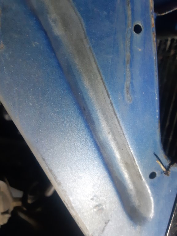

Post by 71440 gtx » Mon Feb 22, 2021 3:08 am
Pictures
Re: Grille blackout treatment
Post by 71440 gtx » Mon Feb 22, 2021 3:10 am
For the black toe treatment that part is never painted it's got the original paint on it
Post by 71Beeper » Mon Feb 22, 2021 8:10 am
Kevin, I can't tell what that picture is showing.
Where is that part located?
