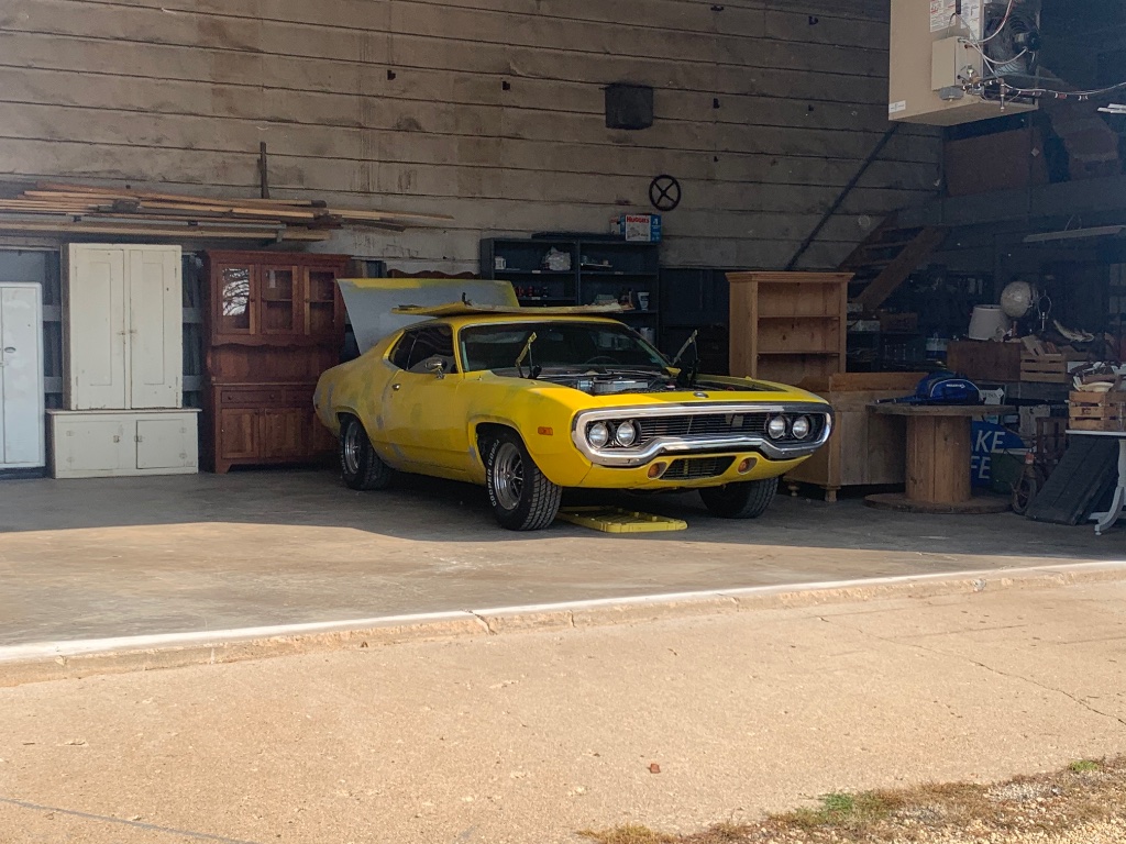

Did the roadrunner in 1972 come with a bench seat and Column shifter as options? Or were they all bucket and floor?
Trying to clone my Satellite and trying to figure out if I can keep the bench for now. Also if I posted my vin what information could I get from it besides production location. I don’t have the fender tag so I’m not sure what options mine came with originally.

Post by sdweatherman » Fri Oct 02, 2020 5:15 am
Just a thorough inspection of your car will show most of the options that were on it - unless someone added them in the past. A/C came with extra holes in the firewall - with an A/C controller and extra venting in the dash. Looks like I see the fender mounted turn signals, and some chrome racing mirrors in the picture. Even the AM radio was technically an option - with most cars having them. The center console with floor shift was optional. Your car with a missing fender tag is a perfect candidate for doing a Road Runner tribute. Have fun with it!
