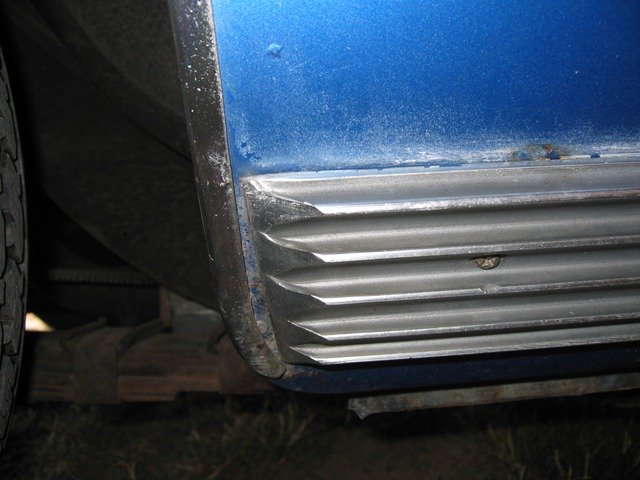

In late 2012 I bought a '71 GTX that needed, among other things, a lot of body work. It was missing the rocker moldings. Some time in 2013 I stumbled onto a pair on ebay listed at $900. When I got them for a $500 offer I thought I had done good.
For the most part, the restoration work finished up this past spring and as I was preparing to attach the rocker moldings I discovered they are about 6" TOO SHORT. Huh?
Otherwise, they appear to be identical to the correct GTX moldings.
Does anyone have any idea what vehicle they might be from? Maybe not even a mopar.
Shown below an actual GTX molding, not mine.

Re: WAIT A MINUTE-WHAT JUST HAPPENED (6 YEARS AGO)?
Probably barracuda gran coupe moldings
https://www.ebay.com/itm/1970-Plymouth- ... Sw6PxcIniV
Thanks, Eric. I think you're right. Now I know how to advertise for a resell. Or I could put them on my '72 cuda tribute.
Not likely I'll ever find GTX moldings.
