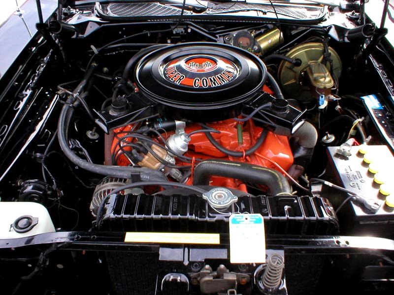

Wondering if anyone can positively confirm that a 71 or 72 GTX or RR with a 440 4-BBL and a 22" radiator would have a shroud. Mine didn't when I bought it in 2012. Listings for shrouds at YearOne and Classic Industries seem to be saying not all 22" radiators had shrouds.
I'm not so much concerned about correctness as that my fan fits in the shroud opening.

Yes, 440 + 4 GTXs for 71 did come with shrouds. Factory manual lists the same part # for 383 and 440 cars, 2998328 (cars without A/C)

I think the 22" was he standard for these cars and AC/HD cooling, ect came with the 26" radiators. A small block wouldn't really need the shroud where a 383/ 440-4 would.
