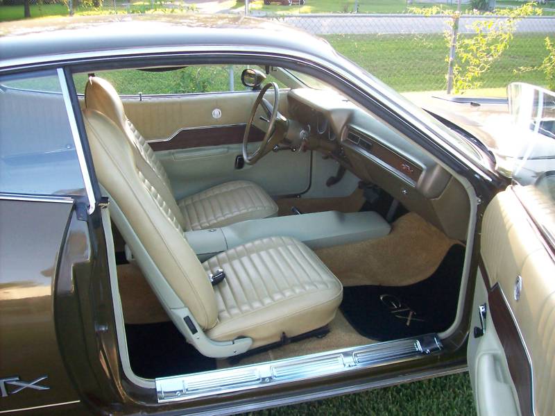

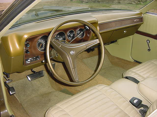

Out of the 11 xxY3 cars I have on file, only 2 had good interior pics. One pic is from a 1971 Barracuda Gran Coupe with P6Y3 interior, and the other pic is a 1972 Charger SE with P6Y3 interior. Don't know if these help or not......

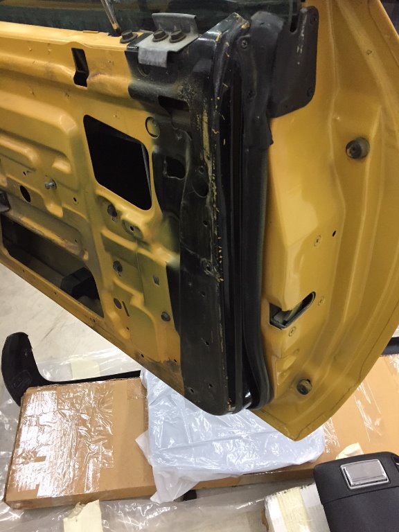

To be clear, if GY4 shows on your fender tag on the second line from the bottom, third code from the left, it is ONLY the door frame paint color. It is not the color of the dash or any other painted parts. The door frame paint is the area painted black in the photo attached.
What is your interior code (second line from bottom, second code from the left)?

for a --Y3 interior, the dash (frame and pad) will be darker than the other plastic and vinyl interior.
1st photo - original car, faded plastic
2nd photo - interior restored correctly

Thanks, these pictures help a lot. My interior is P6Y3. My dash frame is very similar to the pic so that appears to be the only piece that isn't faded or molested. If a repaint of the dash frame is needed how do you find the paint code?

That very bottom GTX picture is what i'm restoring mine to.

That is about as pretty as looking an interior as you can get.

I wasn't too sure about it when I first got my car but it's growing on me. Looks a lot better in that picture with the fresh colors.
