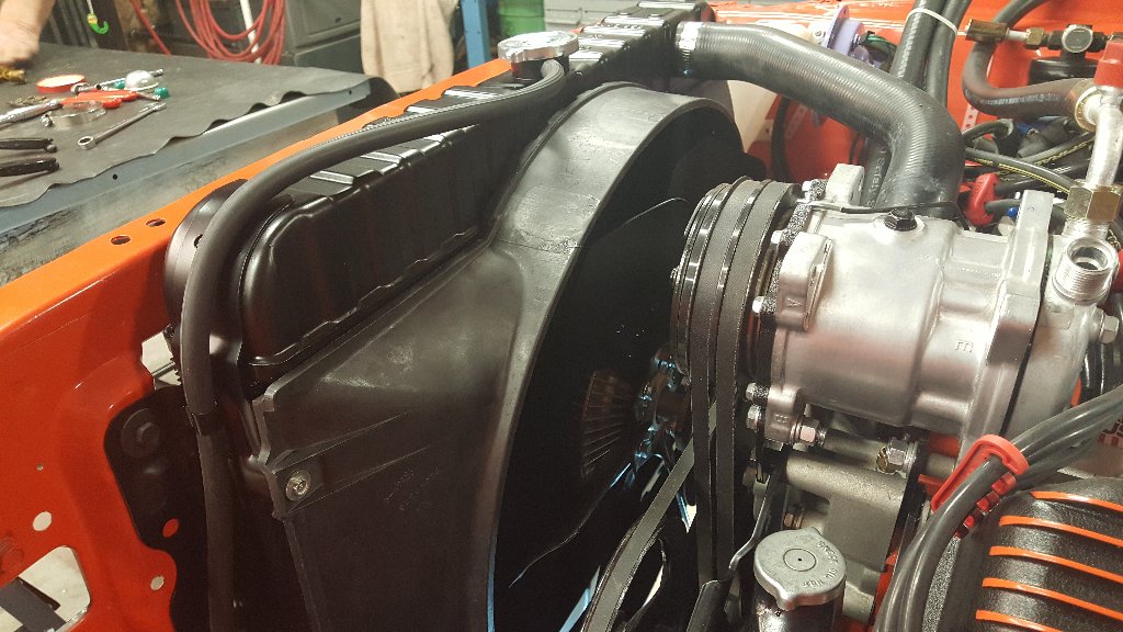

And why do you need a 28 inch radiator? My 26 inch cools my 528 Hemi just fine. Unless your car came with a 26 inch, you will have to open up the support for one. They make 26 plates just like the car would have come with, but I don't know of anybody that makes one for a 28 inch. Call glen ray, maybe they can put their top tank on you core.

My 73 RR came from the factory with the 28" radiator. My RR is a non A/C 4 speed car. Following the advise from above I took it to the repair shop and talked with Glen Ray radiators, decided to go with the local repair shop first, Now it looks like aftermarket until I find the correct one that's repairable.

Sorry but Ive never heard of a 28" radiator back in the day. Either 22" or 26", just saying.
