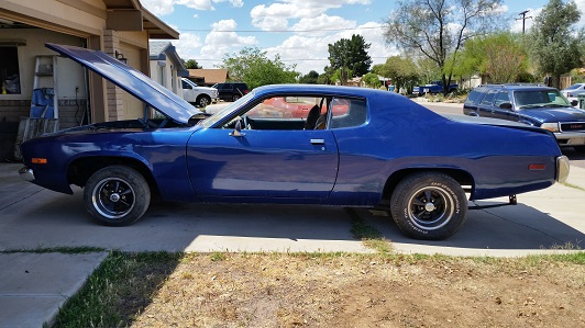

:bump: tried to put this in the decoder and didn't work not sure I entered it correct. Could someone tell me about this car

OK got it but one line confuses me:
KB5 - The provided code/year combo is currently undocumented

71_bronze_gtx wrote:B5 Blue - PPG Ditzler # 2627. Renamed Lucerne Blue Poly on the paint chart. I guess colors look better if you keep renaming them every couple of years.
Ya that came up but the KB5 is repeated twice which results in that sentence I didnt understand

The KB5 above the E24 is the car's body color. The other one above it is the top or roof color. If you have a vinyl top then this would be where that would be coded or if the car was available with a painted top, other than the body color, then the different paint code would appear in that spot. Hope this helps.

Thats pretty much a Satellite With Manual Disc brakes, AM Radio, Manual Outside Mirror, Body side Moldings. 6 Cylinder, 3 Speed manual on the tree, Blue bench seat Blue paint

ILUV72RRs wrote:The KB5 above the E24 is the car's body color. The other one above it is the top or roof color. If you have a vinyl top then this would be where that would be coded or if the car was available with a painted top, other than the body color, then the different paint code would appear in that spot. Hope this helps.
Ya that makes sense so if it had another code it would have meant it was two tone or had a vinyl roof.

Moparlar wrote:Thats pretty much a Satellite With Manual Disc brakes, AM Radio, Manual Outside Mirror, Body side Moldings. 6 Cylinder, 3 Speed manual on the tree, Blue bench seat Blue paint
Thats not what it is now though. Its a 440/727 with bucket seats and no side mouldings

Most of the fender tag decoders on the web are for 1969-1971 cars. Most of the codes for 1972-1974 cars are the same, but several are different. I will check my book sometime tonight.
Re: 1974 Satellite fender tag
Post by sdweatherman » Fri Apr 08, 2016 12:28 am
E24 - 225 cu in Slant 6 - 1 bbl
D14 - 3 speed manual trans, column shift
KB5 - Body and Top color - Lucerne Blue Metallic
B2B6 - Vinyl bench seat - blue in color
000 - Full door panels - no trim paint required
508 - Scheduled production date - May 8th, 1974
949790 - Vehicle order number
U - Built for USA specifications
B43 - Front disc, rear drum brakes
G51 - Drivers side manual chrome mirror
R11 - AM radio (2 watt)
V5X - Black body side protective moulding
Y16 - Sales bank car
END - End of options codes

E24 is a 6 cylinder! That code was used in 72-74 Your vin code should be B C E depending on the configuration.
