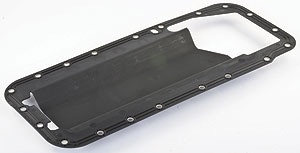

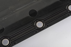

Side note...this windage tray from Jegs is better late than never. What a great alternative to double gaskets...

Well i would try to see if you can get the tray up on the motor with out removing the pick up. I'd put a thin film of sealant on all the mating surfaces. You can use some all thread and needle nose vice grips to hold up the tray. Cut two more pieces of all thread and install them in opposite sides to hold up the pan. Then remove the vice grips and mount them both up on the motor. Just a thought if you are willing to try it. I have an old original Mopar Performance tray still in the original packaging. I will have to take a look at it and see if the design changed at all. I like the double gaskets on the one you posted. Shame mp didn't do that.

I know I have double gaskets on mine, that tray does look nice though. Mine was a little bit of a hassle, too. I couldn't put my windage tray on before the pan because I'd end up fighting the pan rails versus the pickup. Mine did go best as one clanking mess in one shot. Although I did use a Milodon pan. Good luck!

I hear ya, fighting with a stack of four things, and only having two hands. I think my last try entailed me holding the whole assembly up with my face, holding alignment with one hand, and trying to reach for a couple bolts and attempt threading them in with the other hand. Will definitely be considering the Jeg's tray in the future.
