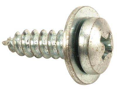

These look like what you need. I'd have to check my car tonight to verify
http://www.rtspecialties.net/proddetail ... od=1000304
71Satellite98661
Posts: 280
My Cars: 71 Satellite
Location: Vancouver, WA
Re: Windshield washer bottle fasteners
Post by 71Satellite98661 » Tue Sep 23, 2014 12:28 pm
Yes. (3) w/ flat washers. Silver cad or clear zinc. This is a photo of a reproduction. I'll have to check the size, #6 or #8.

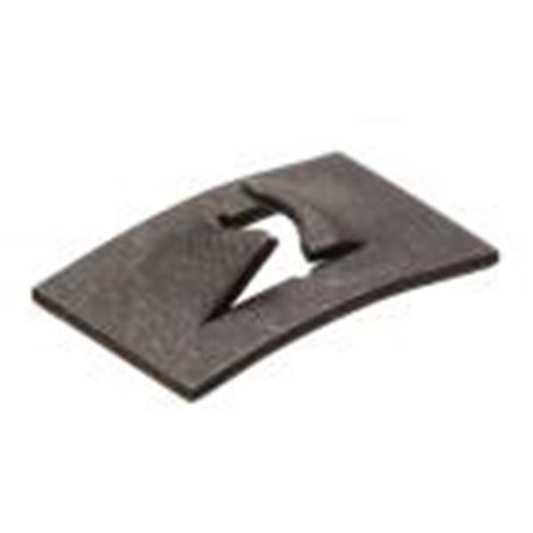

:lol: Yeah one of mine was wallered out. I considered but didn't think a #10 would work due to the limited inner diameter of the brass eyelet for the washer pump ground. I used a #8 speed nut on wheel side of the inner fender. It works until the next time I remove the screw and foret about the speed nut which will inevitably fall and bounce off the floor never to be seen again! :lol:

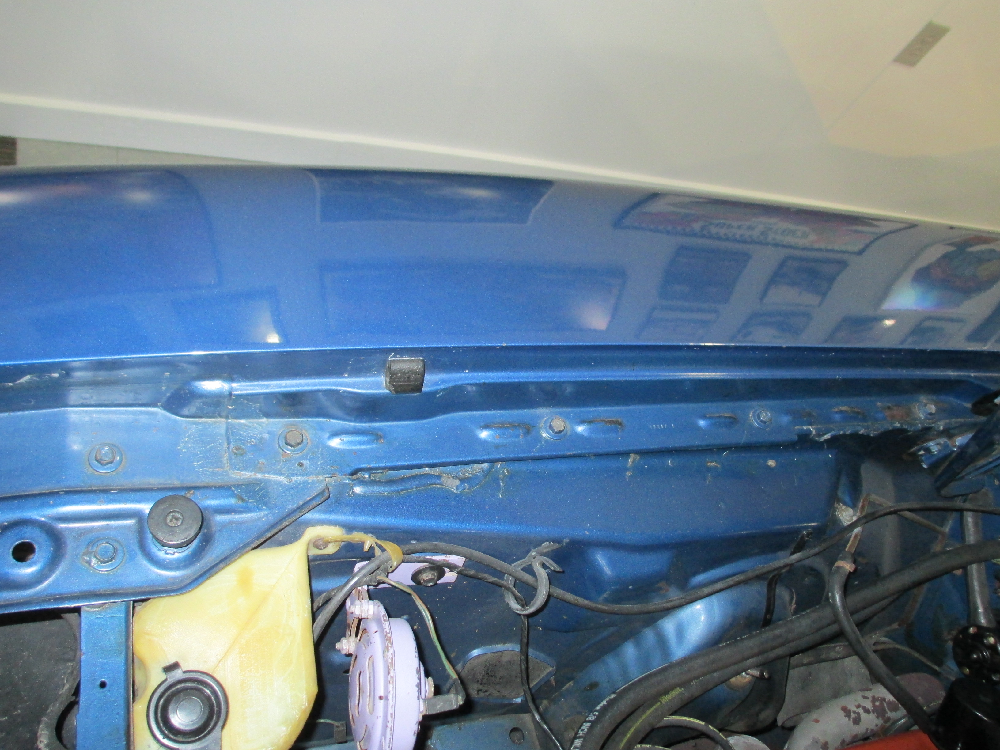

Here's a photo of my original
