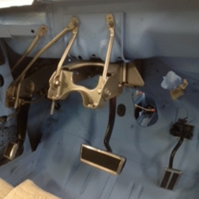

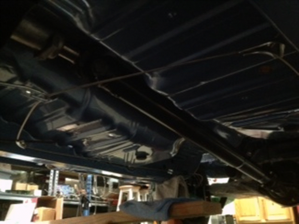

Post by 71Satellite98661 » Mon Aug 18, 2014 12:28 pm
These photos of my car probably don't help too much but worth a shot. I actually found great reference photos in the YEAROne catalog. I think it was a (71?) Charger.
