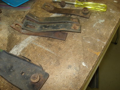

are there little brackets to the left and right vertical edges of the front bumper? Does anyone have a good picture of what they look like? I seem to have spotted them in the "green" thread, but am not really sure what' i'm looking for as I scrounge through my boxes...
thanks Kenny!
sjd
general
- Posts: 172
- Joined: Sat Feb 03, 2007 9:24 pm
Post
by general » Tue Dec 10, 2013 9:36 pm
here you go, they are on the bench
general
- Posts: 172
Post
by general » Tue Dec 10, 2013 9:39 pm

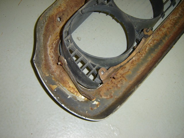

And they go on the side, you can see one in the picture

What is the other part??

by steved » Sat Dec 21, 2013 7:43 pm
Found them in a bag today with a bunch of rusty fender bolts! scuffed, painted, and assembled!! I knew I'd seen them somewhere...
just a couple adjustments, and the front bumper and grille are on.

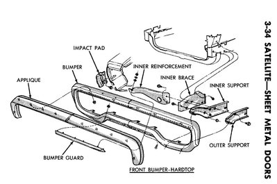

From the FSM, they call that bracket an "impact pad". Don't know why. Maybe to help stabilize the bumper since the mounting bolts are all down low?
- Posts: 730
- Location: Rapid City, SD
Post
by sdweatherman » Thu Mar 13, 2014 8:12 pm
Nope, sorry. The impact pad and the bracket are two separate entities. On the previous page (3-33) in the FSM in circle view V, the bracket is bolted to the impact pad. The other end of the bracket goes to the side of the front bumper. Hope this helps.
