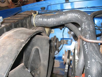

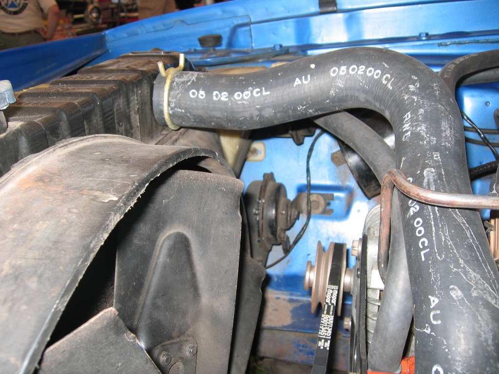

you can barely see the upper horn in the photo behind the rad. hose

Thanks, Eric. I was looking in front of the radiator.
