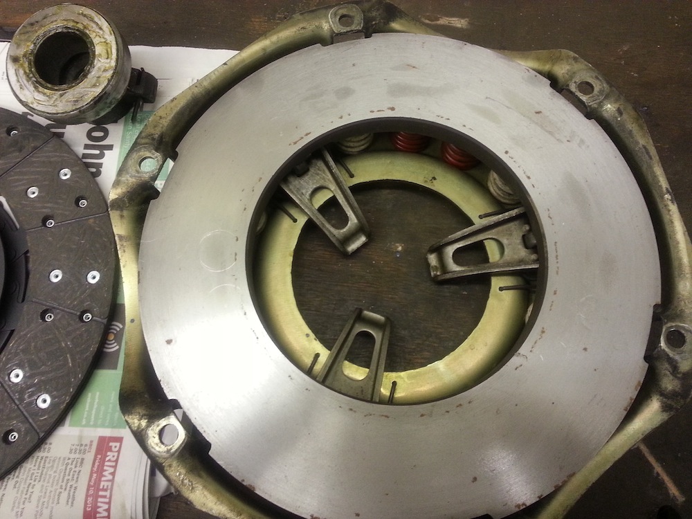

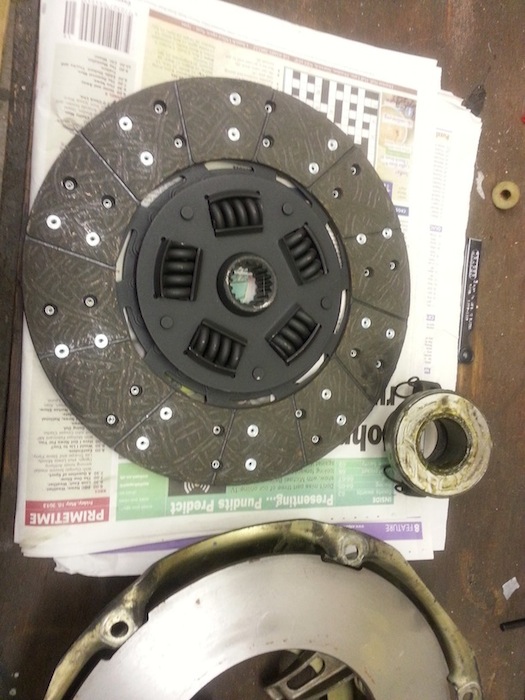

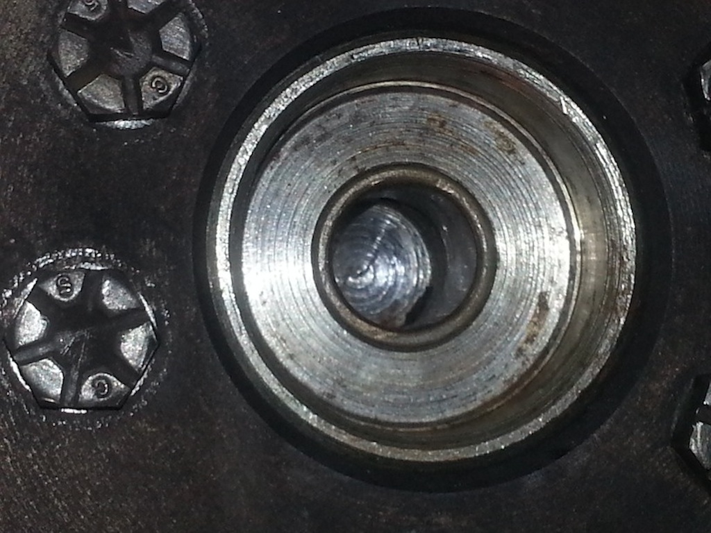

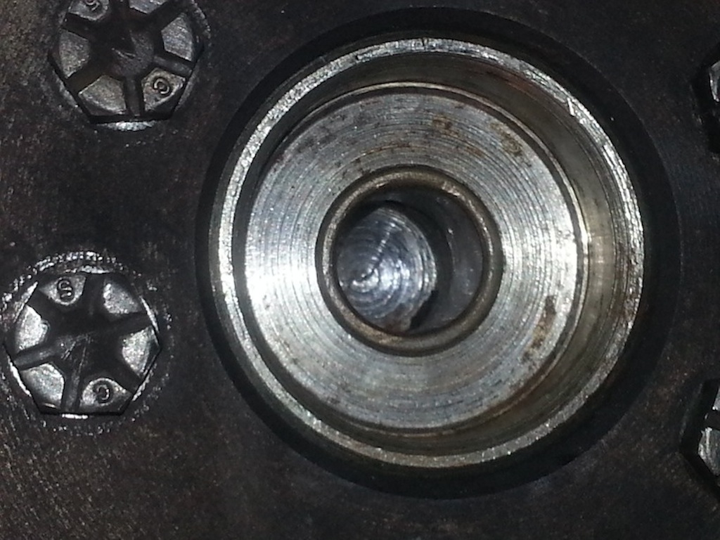

Well, you guys were correct!! the pilot bushing is as dry as can be.
I have the box out, did it on my own with the car on stands yesterday pm :D .
I am going to get new clutch and pp, just to be safe.
The TOB looks and feels correct, has a slight rock when on the shaft.
I shall oil up the pilot bushing as advised, tape half up, then rotate the flywheel.
Thanks again :beer:

Could be worse, at least the bushing isn't all galled up and is still in good shape! :) Just a side note on that bushing. If and when you do a clutch replacement ALWAYS check that bushing and (I suggest) replace it as part of the clutch kit. I had one "disappear" in my `cuda. :shock: One of the guys who taught me said that wasn't too surprising and they will wear out to the point of not being there.
Let us know when shes done.

Yes, the bushing is new, was replaced when the engine was built.
Going to order new clutch and pp today, will keep you up to date.. :D
