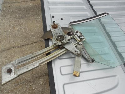

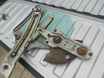

I don't have diagram and haven't messed with it for a couple years, but heres a pic of an extra one that I have. Maybe someone else here will chime in, but I think the regulator is secured by 6 bolts to car and then the plastic slide goes into the channel thats mounted to the inside of the window well.

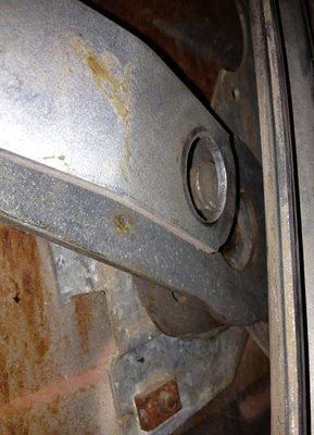

Actually, the reg should be facing this way (window shown in up postion)

Thanks! Can you remove the silver nut with black grommet and post a picture of what it looks like up close? I need to locate one. Also need to figure out what all is there...like bolt, grommet, and if there is a spring or any other spacer?

Do you have the white plastic piece (closest to you in 2nd pic) attached to anything? It should be in a chanel part that is attached to the car on the inside of the window area. That piece is pictured in first pic to the left of window (by itself).

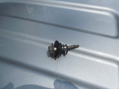

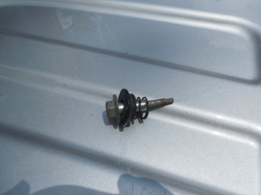

This? Or do you need the square piece too. (If you found the spring, I would double check that area for the bolt if you dont find it PM me)
