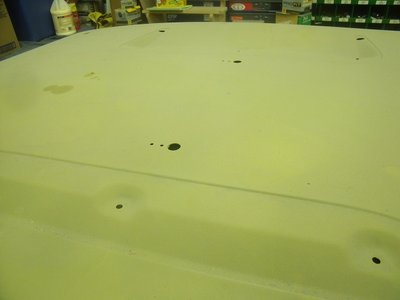

New guy here long time watcher first time poster. Picked up a really nice hood for my 71 GTX and the holes for turn signals are factory punched but are located near centerline of call outs.I've seen this location on just a handful of cars, most are located more towards windshield near rear of call outs.Thought maybe hard to view them this far foward and move them back in later production for easier visibility. Does anyone really know and should i move them????

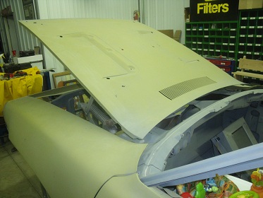

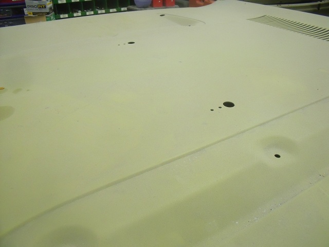

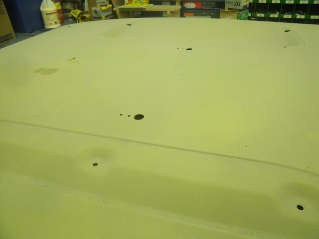

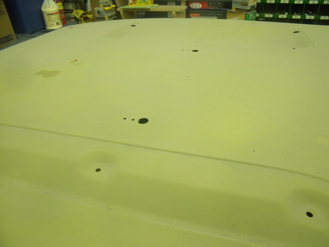

Here are the pictures from GTX158

Here's the pics of my hood notice the holes for turn signals, much farther foward then most. Yes the holes are factory punch.

So now that you can see turn signals are located further foward should I relocate or leave them alone?

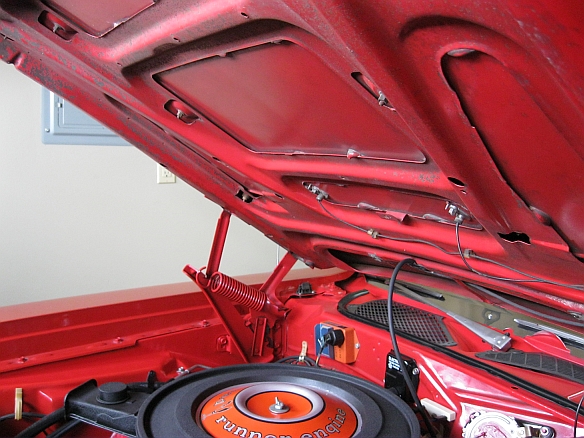

Is it possible with the more centrally located turn signal indicators that there was some interference with the wiring and the air cleaner? See attached pic of my 71 RR with the rear hood mounted indicators. If you look at the location of where the center mounted indicator would be there is possibly an issue rubbing the air cleaner. As far as whether to leave the indicators or relocate them, I vote to leave them where they are now. Do you have the wiring for the indicators? If so did you note the wiring routing? If you have a pic of the wiring installed, we would like to see the routing.
