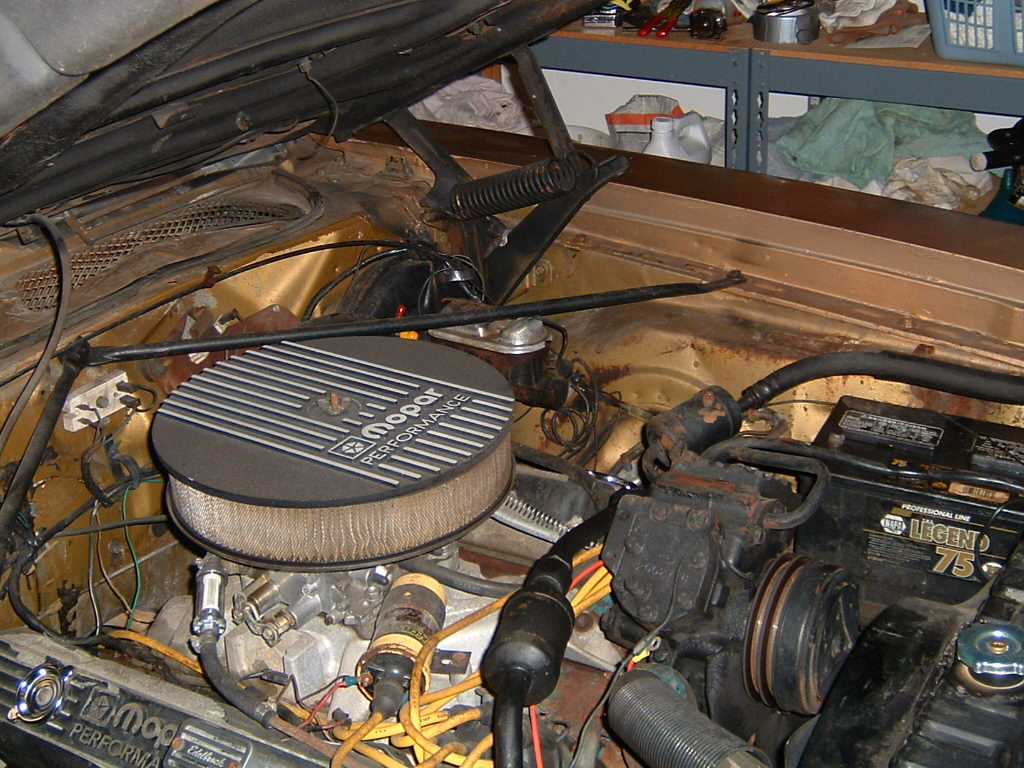

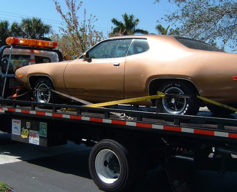

That looks good Jeff. Welcome to the nest from another recent newbie. The casting number doesn't lie - it's a 400. A 440 would automatically make it a Roadrunner GTX,I do believe. I had a 400 RR long ago. Not quite the brute that a 440 was, but a Roadrunner nevertheless.
Hard to tell from the pic - what is the paint code / color? Doesn't appear to need much work. Post more pics and a detailed description. Any history you know, your plans for it, etc.

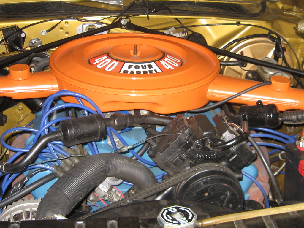

The original color is CY8 (gold leaf poly); however, it was not repainted in the original color. I'm currently working to restore it to as close as original as possible. History: originally purchased by a serviceman, special military order. From what I was told I am the third owner. I'll post more pics soon.
The engine was completely removed and rebuilt with a lot of help from friend, Joe Basile.

Looks like a very nice car there. Let's see more pics.
