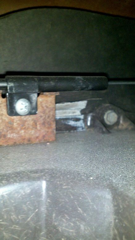

Can anyone show me the type of cable end or clip I need to connect the heater/defrost cable to the heater box.
See picture attached
Thanks
Thanks

Thanks for providing that picture but I think the 72 box is different than what I have. One thing I forgot to mention is that its a non a/c box.
If you look at the picture I posted there is a screw, so it is either somekind of a clip or the end of the cable is molded to accept a screw.

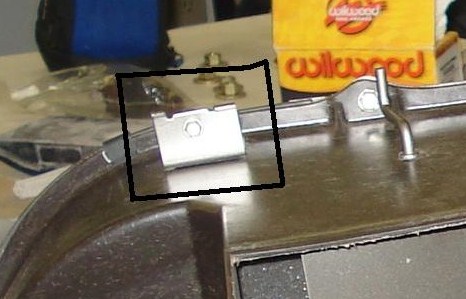

The black tab of the cable is held to the metal tab with a sheet metal screw, cable going over the top, black tab facing down, between the metal bent tabs.
Re: 71B Heater/defrost cable
That's what I ended up doing altough it looks weird. I find the cable end a little too high that it does not sit down on the lever too much. I'm afraid it will pop out. So I put a push nut on it to help with that.road chicken wrote:The black tab of the cable is held to the metal tab with a sheet metal screw, cable going over the top, black tab facing down, between the metal bent tabs.

No that's right. If you look at the heights on the metal tabs they are different to make up the difference in the cab;e and the plastic end diameters.
The cable end does not go over the door arm. There is a spring steel clip that slides over the door arm and the cable goes through two slots in the clip. That is where the adjustment for that cable is made... by sliding the cable in those two slots so the selector will line up with OFF, HEAT and DEFROST.
That is what I'm missing, the spring steel clip,I can see that would do the trick about the cable being too high. I also missed the height of those tabs, they are different. Now got to find one of those clips, thanks for the help.road chicken wrote:general wrote:That's what I ended up doing altough it looks weird. I find the cable end a little too high that it does not sit down on the lever too much. I'm afraid it will pop out. So I put a push nut on it to help with that.road chicken wrote:The black tab of the cable is held to the metal tab with a sheet metal screw, cable going over the top, black tab facing down, between the metal bent tabs.

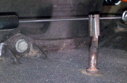

I took some pictures of the clip and proper orientation of the cable to the tab. I'll post them later after I get home.
that should do it
Hmm seems the links aren't working now
Hey Road chicken, those pictures are perfect. The links worked for me. Thanks again for your help that is exactly what I needed.
