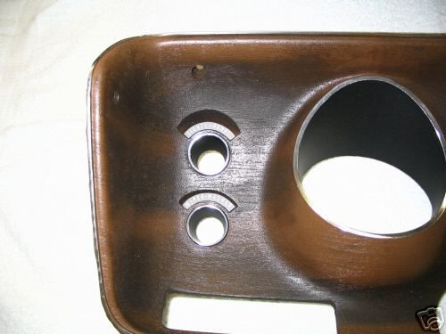

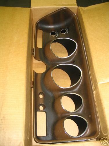

Re: how do you?
NOS bezel for painting reference
- Posts: 394
- My Cars: 71 roadrunner
- Location: lethbridge, ab
Re: how do you?
^Thanks!!!
