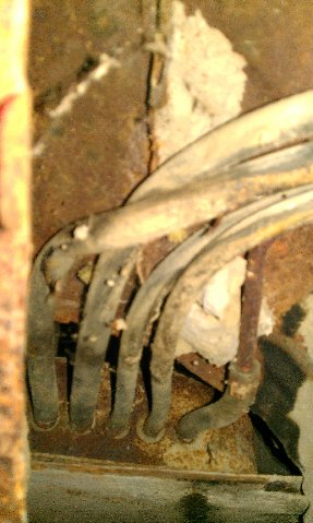

OK do I need to hook the 4 vents up on the new tank or plug them. Not making a show car. The tank was removed when I got the car. The new sending unit has a vent or return line also(which one?). The metal line for that is there but I have no Idea what to hook it to up in the engine bay.

Thanks for the help guys. The return line. It seems like there was three lines on the fuel pump on my 71 road runner that I sold in the mid-late 70's. was one a return? The pump on this 71 440 GTX has only two lines. In from tank and out to carburetor. There is also a canister under the drivers side front fender that is not hooked up to anything. It has a line that runs up close to the brake booster then ends. The vents in the tank are like the picture you posted, thanks for that. There is another line that runs alongside the gas and return line. It also ends in the engine bay hooked to nothing.

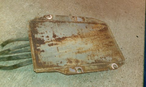

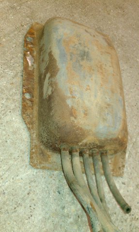

I went and took the separator off and though it is uglier than a 58 Chevy, it does not seem to have been compromised by the rust. I may coat it with Ospho before I re install it? ? ? When you turn it from end to end I hear one little something fall. Where do you get the fuel filter with the return line on it or do I need it?

seperator
