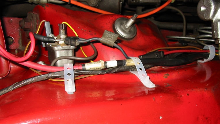

A 71 RR does have a fusible link. It is found connected to the large stud on the starter relay and the other end is connected to a fairly large red wire via black connector. Check the fusible link wire where it enters the two connectors. See pic below.
Ron
Ron
