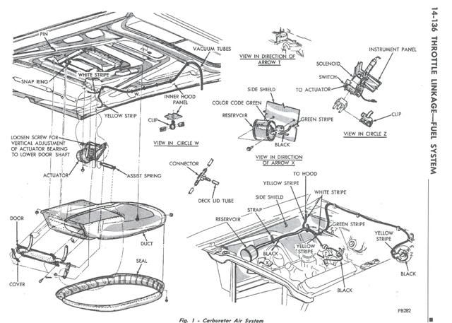

WHAT IS THE CORRECT VACUUM LINE HOOKUPS FOR THE SWITCH AND THE SOLENOID ?

THANKS FOR THE DIAGRAM. WHERE DID YOU FIND IT? ---- RALPH49
Re: AIR GRABBER VACUUM LINE HOOKUPS
Post by 72RoadRunnerGTX » Sat Apr 21, 2012 10:19 am
Page 14-136 in the 71' Factory Service Manaual.
