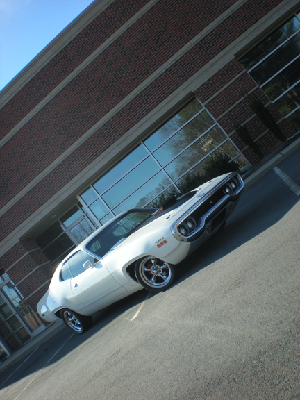

17" TTs on mine. 4.5" backspace. It could use more height... 20s would work.
- RRFrnt1.jpg (252.43 KiB) Viewed 14605 times
Re: Lowering Suspension/Wheels
20s might look nice, but it'll ride like crap and track even worse.
If I were to consider using wide low profile rubber up front, first thing I would do is invest in some aftermarket control arms with additional caster built in. That will help keep the wandering to a minimum, but it won't improve the ride.
