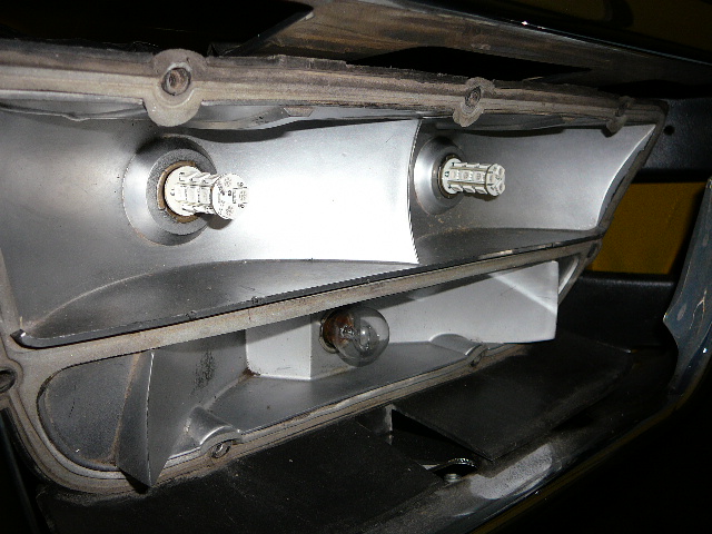

Anyway, I got tired of dealing with the symptoms and figured that I'd experiment with drop in LED lamps to replace the 1157 bulbs out back.
If you've ever shopped for these, you know there are many configurations, and some are quite expensive.
Biggest problem is the reflector and lens optics in the tail lamps are design for the 1157 incandecent bulb. Light output from LEDs is quite different. Most of the drop-in LED replacements you'll find at the auto parts stores will yield a dot of light in the middle of the lamp.

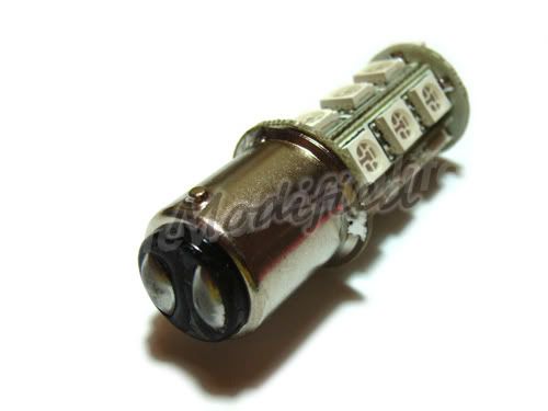

After doing my homework, I discovered this type would most closely emulate the 1157 bulb:

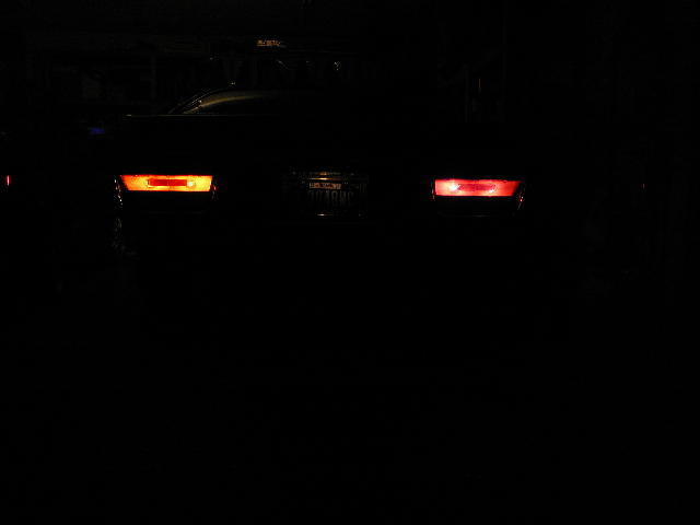

I purchased a pair off ebay with the intent of installing them on just one side for comparison. They attached pictures show the results. I'll let you guys guess which side has the LEDs.

They look really nice.
Can you let me know if they are brighter in daylight use too.

Post by 471Magnum » Sun Feb 05, 2012 12:11 pm
These have pretty much the same light output. I stayed pretty conservative.
You can get some with more LEDs, but then you can be glaring in the face of following vehicles. That can be pretty annoying.
I'll try to get some daylight shots today.
