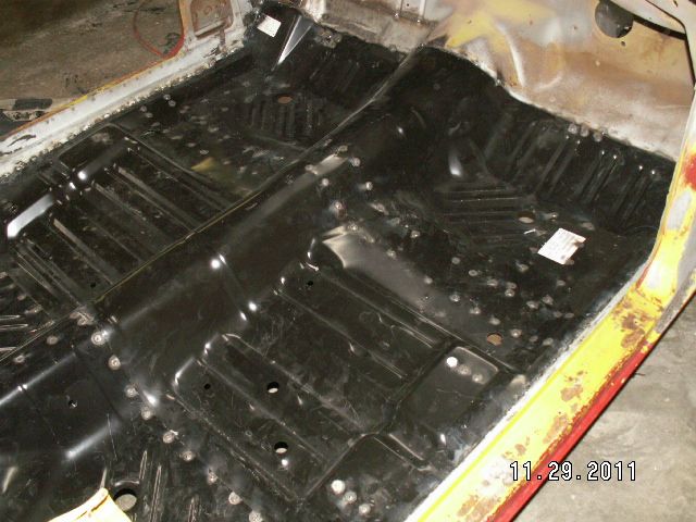

Guys - does anyone have a photo of the floor where the bucket seat track holes are located?
I'm just about finished installing the new drivers side floor pan and since my car came with aftermarket seats when I bought it I think the original seat holes were plug welded and new holes drilled.
farmboy70
Posts: 136
Re: Holes in floor for bucket seats.
Post by farmboy70 » Fri Dec 30, 2011 8:26 am
Heres one for now ,I'll post a better shot tonight.

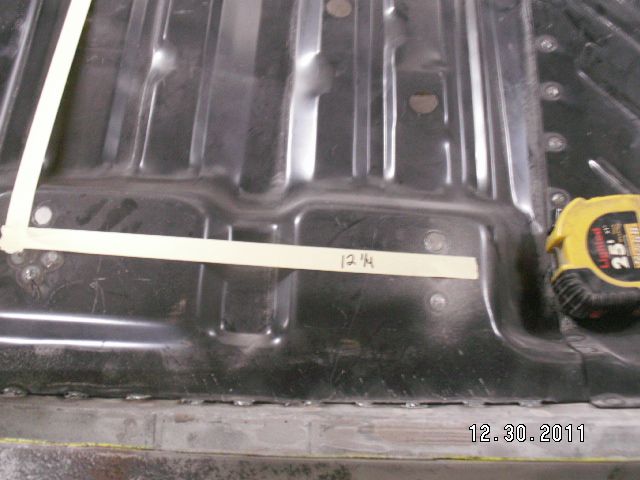

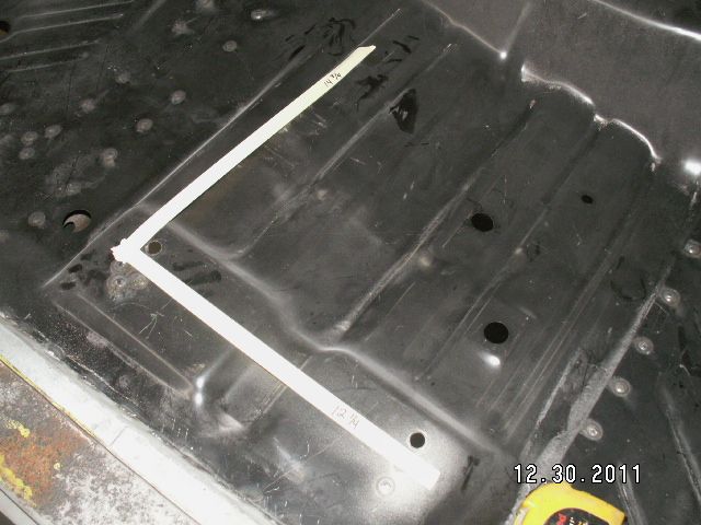

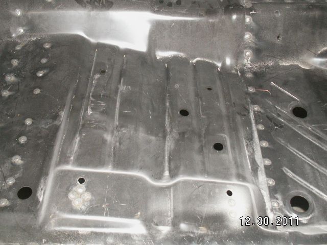

Post by farmboy70 » Fri Dec 30, 2011 10:07 am
farmboy70
Posts: 136
Post by farmboy70 » Fri Dec 30, 2011 10:12 am
Center to center on the measurements.

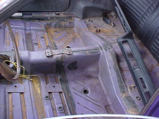

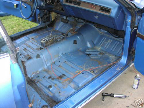

Post by Eric » Fri Dec 30, 2011 11:54 am
center hole braces welded to the floor plans....
Post by 71Beeper » Sat Dec 31, 2011 12:18 am
Many Thanks to Dave and Eric for the very helpfull pictures!!!!
